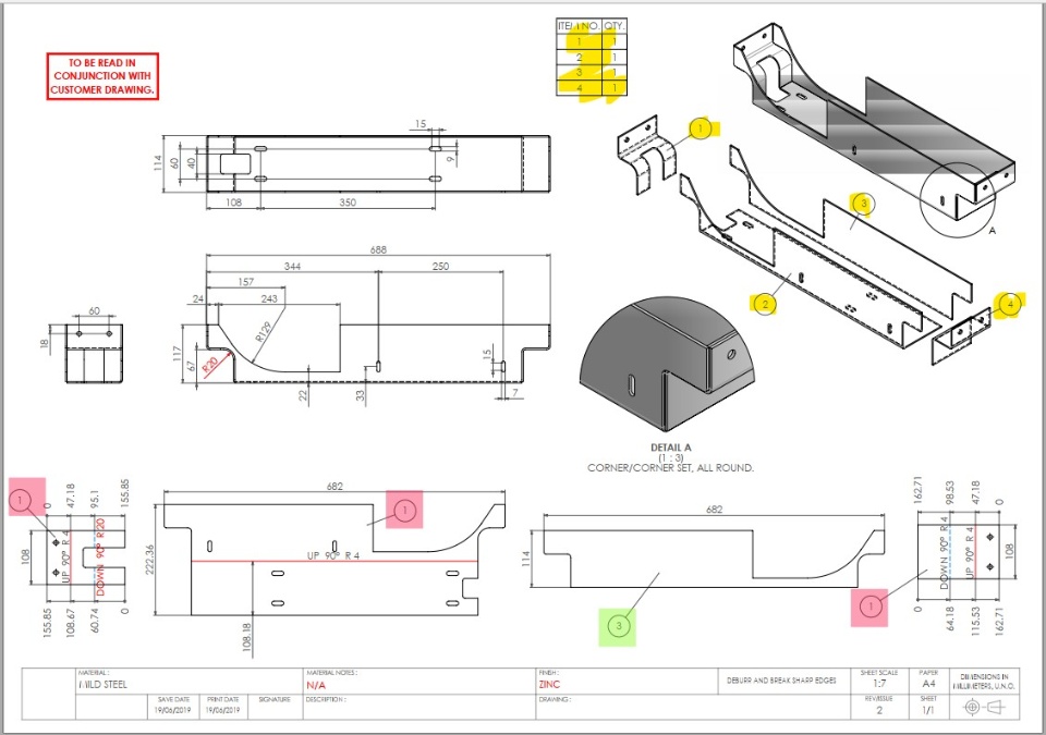

Hi all,
Any help would be much appreciated.
As described in the title, I seem to have developed a problem attaching balloons to Flat Pattern profiles created within a multi-body SLDPRT file. I say developed because I recently upgraded to 2019 and that's about when the problem started to happen, whereby balloons attached to flat patterns would only return the default Item number '1', rather than be linked to the highlighted table (how it used to work). I work around it by forcing the balloons to be a text input but this isn't ideal.
It is isolated to the flat pattern views. For instance, I can attach balloons to any of the other views and they stay relevant to the highlighted table (which originates from the hidden view isometric). You can see the isolated Item 3 returns the correct number. This is a sheet metal item with, obviously, no bend information.
I'm using a Weldment Cut List table to generate the table but get the same result using a BOM list with Detailed/Flat numbering.
I'm aware generating the Flat Pattern profiles creates a new configuration within the part, so wonder if it's something to do with this? Or perhaps something I'm doing wrong along the way?

DE 2021-04-09 Best Answer
Right click the view(s) and select Properties. Bottom left side of the window check "Link balloon text to specified table" and make sure the desired table shows in the dropdown box.

I have been able to find the SPR 1133600: Unable to use option 'Link balloon text to specified table' for flat pattern views of multibody sheetmetal part
This issue is implemented in SOLIDWORKS 2019 SP4. SP4 will likely be released within 2 month

Managed to get the SP 3 update done this morning with mixed results!
The update seems to have 'opened up' the drop down, letting me freely choose which table a view reports to. This is something of a revelation in itself and I can definitely see use for it elsewhere, which is great. However...
...it still doesn't work for flat pattern views, as shown. In the instance shown, it completely forgets the Weldment Cut List, allows me to select it be linked to the BOM but only reports an asterisk.
I thought perhaps it was a conflict of interest between the two table types existing in the same space, so have tried drawings with either/or (with a model from scratch each time). I've tried various methods of trying to achieve my intention: inserting the flat pattern view differently (dragging from pre-defined views, selecting body and flattening/copying a correctly ballooned view, selecting bodies and flattening/dragging a view fresh from 'Model View, selecting body and flattening), having a model drawn to include a Boss Extrude feature rather than all Sheet Metal, even fresh drawing & table templates. It's a frustrating one because I definitely haven't changed my method between 2018 & 2019 and is a feature I used quite frequently.
Not the most explanatory screen grab but I'm drawn back to the FLAT PATTERN configurations which drive the Flat Pattern views. The above ballooned fine, reporting back the relevant number for either table when it was just a standard (Top) view with the circular body isolated (fine in this instance, given there isn't any bend information required). It was only when I checked the 'Flat Pattern' box and it changed to it's Flat config (it's modeled as a Base Flange), did the balloon lose it's link, so to speak.

What kind of table did you insert? i just tried this with a multibody sheet metal part and a weldment cutlist and it appeared in the dropdown for me. I also use this almost daily for a regular Bill of Materials.

I don't often use Balloons, but other users here have reported that problem with the early versions of SW2019.  It's fixed with service pack 3.  Can you update?
