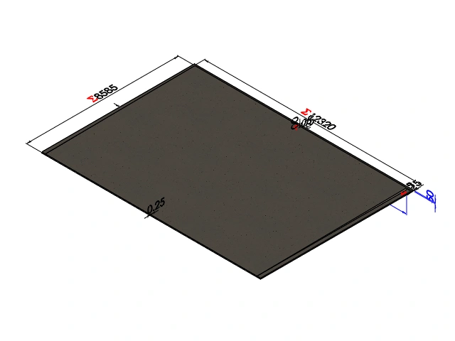

Hi all. I'm looking for ways to improve the way we create a particular assembly; in this example it is our insulated floor.
All projects will use a similar floor, the difference being either the length, width or wall panel thickness (any one of these could be different from the previous job). There are always two internal components; the "concrete plinth" and the "mock enclosure".
These two will always stay internal as they're never drawn as individual components and are reference only.

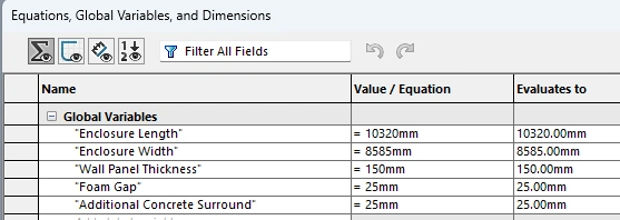

I would like to drive the length, width & panel thickness parameters by equations in the assembly:

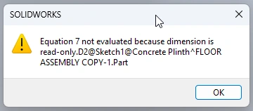

This all works well and I'd like to use this as a template assembly. However, my problem comes when I want to save this template for a new project and change the variables accordingly.
I always get the "Equation x not evaluated because dimension is read-only" warning:
I've tried pack&go, save as with references and copying, pasting and renaming in a new folder but it's always the same.
How can I stop this occurring and begin to use this as a template assembly for future jobs?

Set up your Property Tab to drive it, see video.  Or look into using DriveWorksXpress, it is a free Add-In.
JS
JS 2025-11-22
If you want to stick with Virtual Parts, you can create a Base Sketch in the Assembly that drives your Virtual Parts.  The Dimensions in the Base Sketch can be used in DriveWorksXpress.  Also, if you feel like trying a Layout in the Assembly to drive the Virtual Part, the Layout's Dimensions can be used as well.
