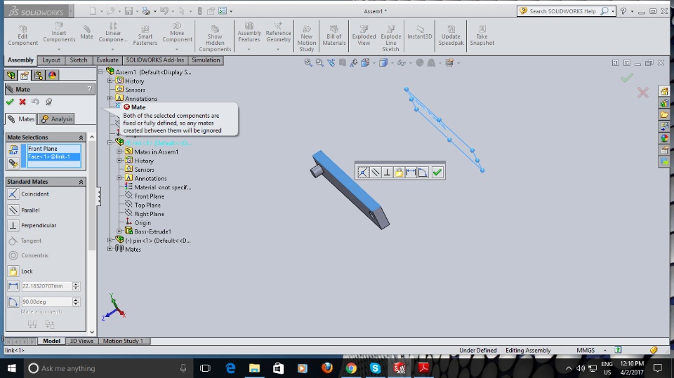

I want to create mate between my part and front plane. I want to get it close to front plane and the origin. But, it won't allow (check out the picture) because they are fixed already or fully defined. I selected all side. I also tried to mate the front plane of the part with front plane of space but it won't allow that too.

It looks like the link assembly is already fixed
It might have been fixed in position when you insert into the main assembly
RMB click on the link and select "Float", then try to add the mates
