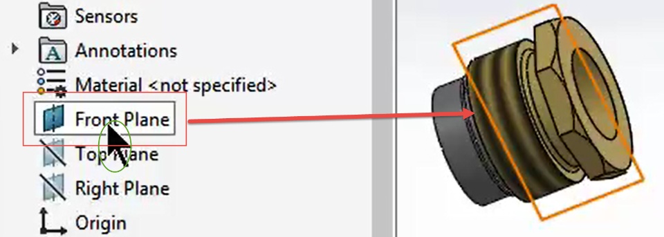

If cursor hovers over plane icon only plane is visible otherwise plane is not visible in assembly file. Is there any other way to make plane permanently visible in assembly file, like in part file ?
SolidworksAssemblies
by the icon, that particular plane is set to be shown. so you probably have the view of all planes turned off for the file. if you have the default heads up toolbar, there is a view dropdown there, make sure planes are selected. otherwise the command is under the view command list.
Thanks for your help.
