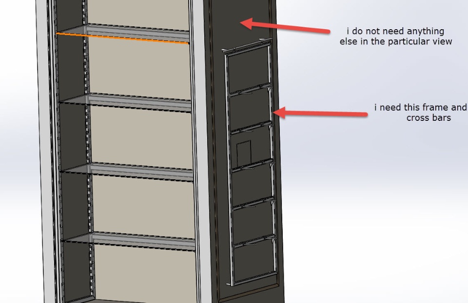

i have an assembly and i created the parts in context. i had issues with creating sub assemblies (something to do with losing the mate references which i did find surprising) so everything right now is top level. I am not ready at this stage to send parts out to separate paths as assemblies because i do not want to get into issues again and lose my mate references, So, my assembly has many parts and i only need to show some of them in a configuration. Cant seem to create an assembly configuration so i am looking for some help.
here is my assembly image with a pretyy clear indication of what i need to display. i only want the metal frame, not the unit behind it because i only need to detail the metal frame. everything has already been done and this frame has been added on.
how can i separate this from my assembly in a drawing view or create a configuration in my assembly to only show this frame?

You can create a new Configuration in the assembly and create a New Display State.
With the New Created Display State , Hide all other Items which you need and Save it. You can Use this same in the Assembly also.

thanks for the reply. I tried to add a configuration but i didnt seem to have any options. Quite possible​ its me because im new to SW..... Are you able to describe how to create a new configuration and display state?

To create a configuration, select the configurations tab, then right-click on the top of the tree and select "Add Configuration". You could then hide or suppress any components you don't want to see. But suppressing components is going to cause problems with mates, etc.
If you just need a view, you will get much better performance with display states, because there is little computation when switching display states. At the bottom of the configurations tab, in the display states field, right click in space and select "Add Display State". Any changes you make to the appearance, including hiding components, is saved against the current display state. Pro tip: you can hide components by holding Tab and dragging the mouse through them.
To choose the display state to show in a drawing view, right click the view and select "Properties".
If the parts are virtual, you cannot create drawing views directly from them, for some reason. But if they have been saved external, you can. And your in-context mates will be preserved. If you just create a drawing view from the part, you will not need configurations or display states.

thanks for the replies. Mike, your solution worked just fine. I had a few minor things to get over lol. I selected what i wanted, select  the "invert selection" tool but couldnt hide the rest. I found that by clicking ctrl and right clicking the selected objects allowed me to hide them. I also found that if i made a mistake, i had to "show" every object individually in the tree as i couldnt find anything to allow me to show all.
