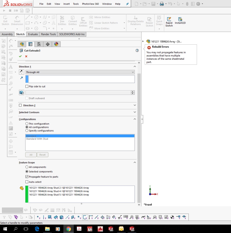

Is there a reason SolidWorks won't let me use feature propagation when I am creating a feature in an assembly that I would like to propagate to the part level? Even when specifying that the parts to be modified (which don't include any of the sheet metal parts), I still get the error as shown in the images.

Try to just pick one feature at a time, it is telling you that you are trying to propagate three features to the same part, just pick one, then do it again for the other feature...........

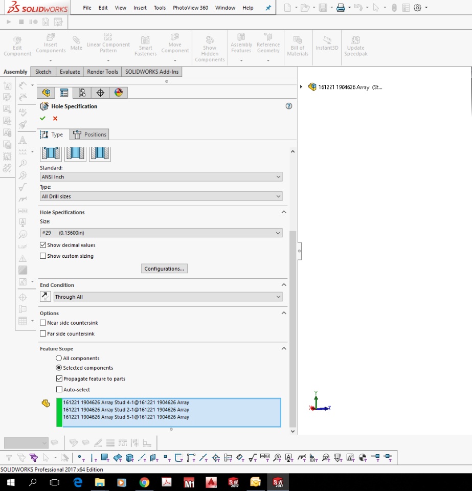

Thanks for your response, I am only selecting one feature to propagate. It is a simple slot in the stud sidewall. The three items selected to cut through are three different parts (they have the same dimensions, but are individual entities). I have linear patterned parts that are also sheet metal, it appears that these parts are causing the feature propagation to not function. Strangely, I can get it to work with a hole using the hole wizard, but not with a cut-extrude feature that I create the sketch for.
The other option is to edit the parts and convert sketch entities from the first feature on each part (a total pain when dealing with a lot of parts). I just don't understand the restriction, when the parts that I am selecting for the feature aren't the sheet metal parts that I have a linear pattern of.

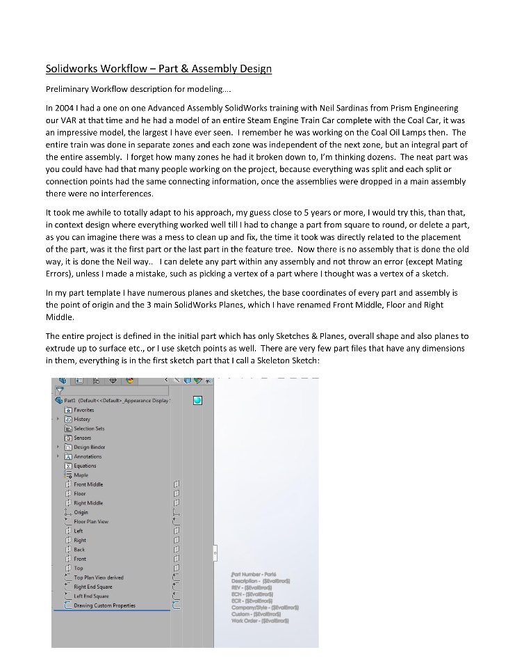

Do yourself a huge favor and change your design/modeling experience to using a Skeleton Sketch/Master Sketch or a dummy part to control all your geometry...

I think I am a bit confused John, if I have a hybrid model (top down and some mated components), wouldn't I need to create that cut-extrude feature at the part level at some point? If I wanted it to be in context, would I need to do that at the assembly level in my skeleton sketch and then create the features individually based off the skeleton?

Sure you add all the features in the part level, however the geometry is all in the Skeleton Sketch and is controlled at that level.  I took me a long time to get this portion of Design right or rather stable parametric designs, (you can always design better things or better practices).  For a snapshot of my workflow see the attached and if you have any questions, ask...
There are many different approaches, however, for me this has been the most stable and it is fun to see everything move right after a dimension change, without exploding my feature tree or having any errors...

Thanks for your response again, I can see where you are coming from with the importance of a stable parametric design. It took me a bit to figure out that the skeleton model was the most stable. I just need to place all the features individually at the part level, which will keep me from running into issues like this.

Even though designing somethings top down is great, it's not always great for all the end users that I am going to have working on the model in the future. I can use top down to get the general size and shape of our product, but then my end users need to be able to simply add items using mates. I typically want to use a hybrid approach, and in this case the propagate feature should work to allow my end users to add an extruded cut easily at the assembly level, but instead I get an error when I'm not even attempting to cut through a sheet metal part. I just don't understand why SW would limit it.

I had the same error as you. I solve that error, but I don't know cause of that.
This is my solution. It's very simple.
All of your Assembly of components set to 'Lightweight'.
Then Try again Assembly features.(In my case, Assembly features is Extruded Cut.)
