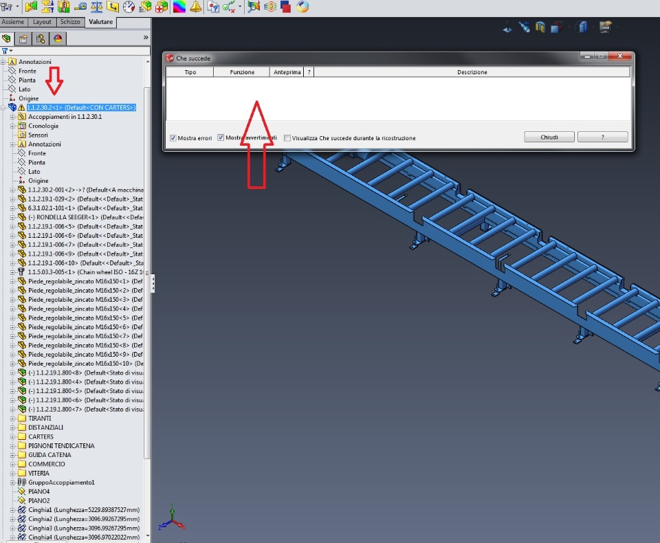

Hi all,
sometimes an assembly gives me an error but I cannot find errors.
I've look everywhere inside parts and component.
No errors to delete.
Does anyone knows this issue?
Attached an image
Thanks
SolidworksAssemblies

Your error is a Rebuild error. Check tick mark in the above 2 images which are highlighting of red boxes and then press "CTRL+B or CTRL+Q"

Hi,
unfortunately this not solve the situation.
I think the problem is not a rebuild error because in the feature manager the assembly is not "red colored" but yellow colored.
If I search for errors or something inside it's parts I cannot find any.
I can send the entire model for check
Thanks

Hi,
download it here: http://we.tl/H7uppRLMvk
The file to open is 1.1.2.30.1.sldasm
The first file in the feature manager that gives yellow error is 1.1.2.30.2
Thanks for feedback

LM 2015-02-19
I solved the problem.
It's strange but it was just a "configuration" problem.
I changed the name from "default" to test and that's it...
Thank you for your time
