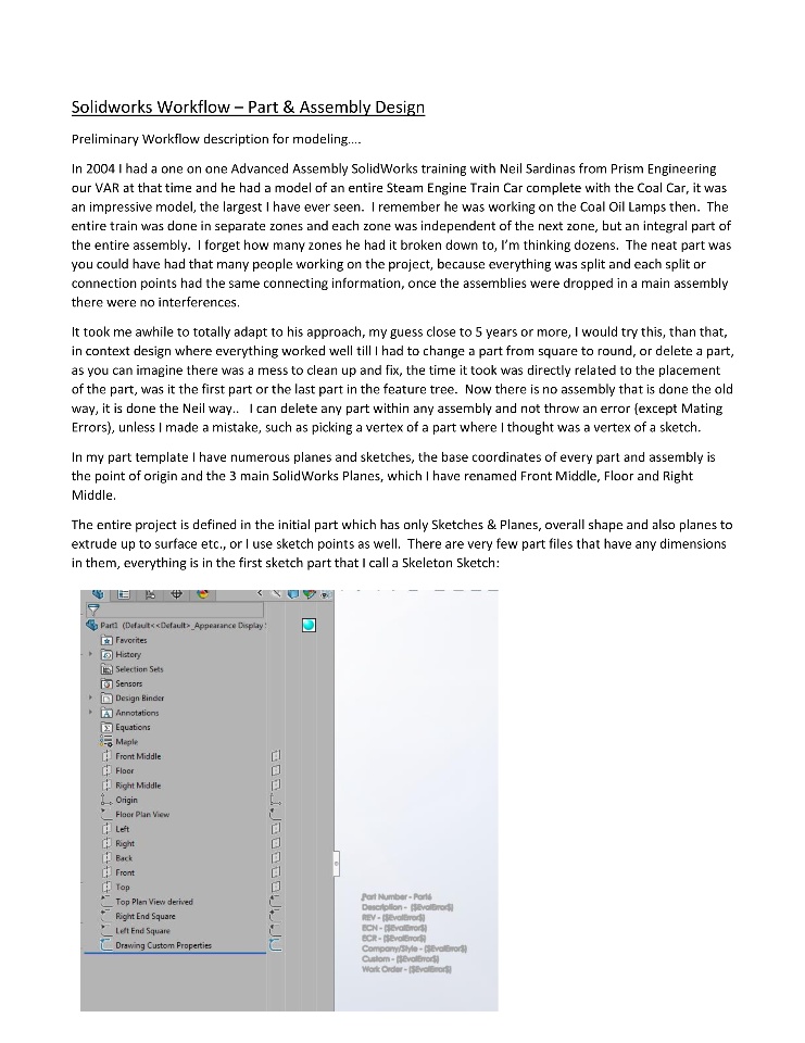

I use a Master Sketch or what I call a Skeleton Sketch Part - so all the parts in any assembly Main or Sub-Assembly is directly related to the Sketch Part, so when I go to Insert/New Component, I save the part right away and always select the Front Plane, then I close the sketch without drawing anything and that is when I select the new part in the feature tree and the skeleton sketch part and right click and hit Isolate
This assures that I only picking lines or a vertex from the proper area/source...
I have a preliminary Workflow attached - which explains a little more....
