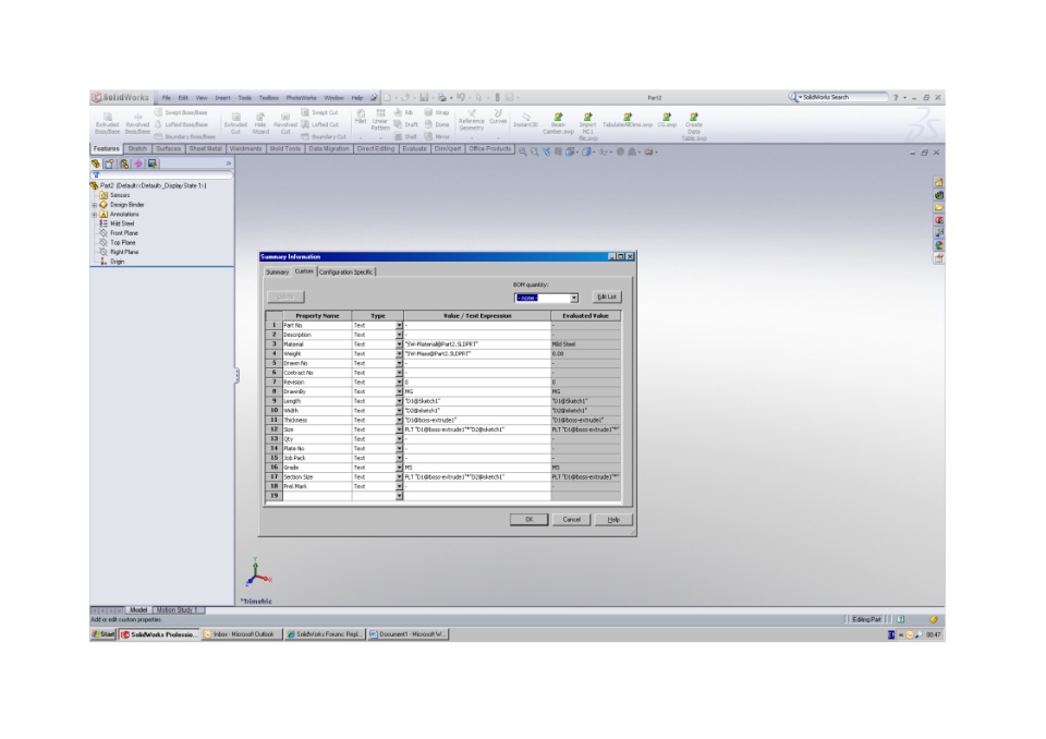

If you have a custom properties tab defined, you will see all these properties listed in the task pane, upon selecting your component. If you have several components selected, you will see only the common properties listed in the task pane.

Could you please explain how I can set this up so it reads items from my Part Custom Properties list.
I have done a help search and cannot get it to produce a call out box as you have shown.
Attached is a screen shot of my Part custom Properties tab.
I would like to include in this call out box the following Part No, Material, Weight, Drawn By, Length, Width, Thickness.
Any help / info would be greatly appreciated.
Thanks
Mark (SolidWorks 2010)
