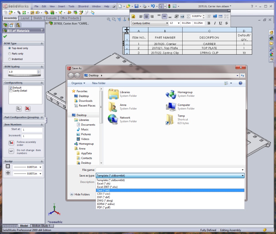

Two options for you without a Macro.
Select the BOM so it has focus then go to File > Save As and select the File Type you wish to save to.
Select the BOM in the top left corner cross and RMB > Save As
See attached images....

Thanks Anna, but I would rather use a one click macro that would then process the file to generate a .xls parts list and manufacturing bom.
I have done a version that is created from a drawing, but I want to try to eliminate the drawing process and create from the assembly if possible.
My plan is to have an indented BOM manually inserted into the assembly. We would then tidy up the appearance (hide some rows & sort the item numbers etc).
By having the bom in the assembly, it will be available to our manufacturing people as well when we save the assembly as an eDrawing.
