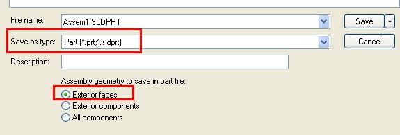

You could Save your assembly as a Part.  When doing so, there is an option to save only external faces.
You can then add this part to your drawing in a hidden view and get the Surface Area.
DG
DG 2011-01-04
Do a saves as of the assembly and set saves as type to part. In the option select "Exterior faces" Now you can measure the outer surface area as required.

I have been trying to get the Save as external faces only, but it does not seem to be working. If you get a assembly that includes tubes, it still counts the inner faces as an external face, if the tubes are open ended i think.
any help ?
DG
DG 2011-01-05
Hoe bout creating a planar surface on open tube ends and then convert assembly into part with exterior faces.
