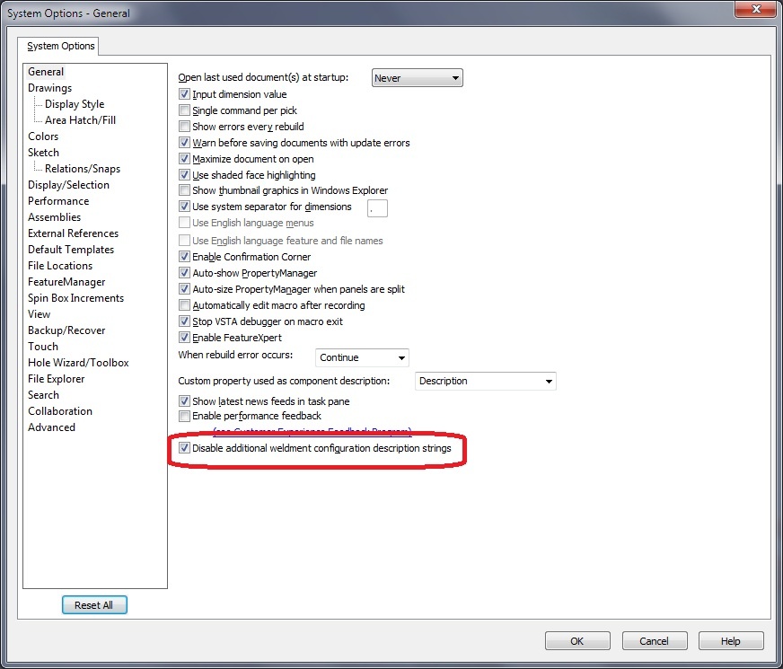

    We are using weldments to create our parts and thus our drawings. In the drawing title block, I have the "drawing number" linked to the configuration name.  How can I get it not to say "as welded or as machined".  In the actual configuration we delete the one.  The remaining one, if you double click it to change the name, SW does not give you the option to delete the txt "as machined".  Anyone know?

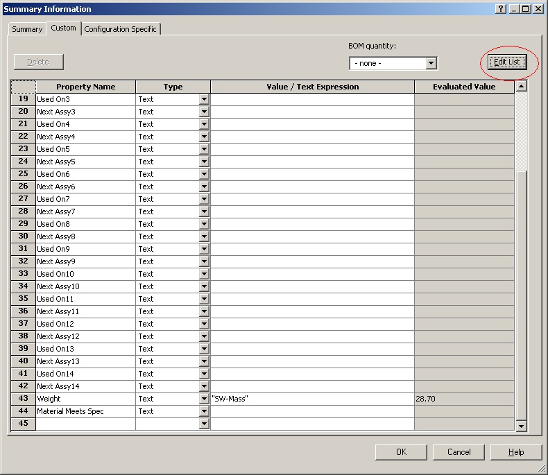

I don't think you can get rid of it, but you could work around it.In the prt file go to properties / config specific, pick a property from the drop down you do not use and type your name number or whatever into the value/txt expression, then link to that. I know you should be able to rename the weld config directly.... Weldments / cutlists can be a pain.

see jpeg.
it will not correct existing parts, only works when creating new part.

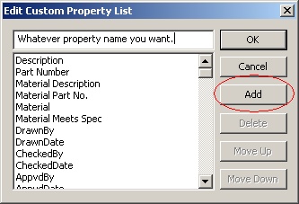

Without adressing the issue of renaming configurations (I recall having to make a new configuation named whatever I wanted, and then deleting, or ignoring,the one I didn't want) I wanted to point out that you are not restricted to the default properties on the dropdown list (I remember the days when they were the Windows file properties and none of them made any sense for drafting). Click on the "Edit List" button in the upper right corner of the "Summary Information" dialog box and add what ever makes sense for your purposes.  Or delete the ones you don't use  to reduce clutter.
