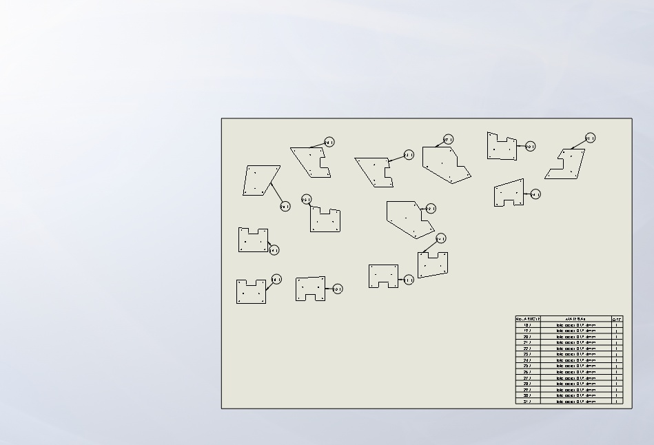

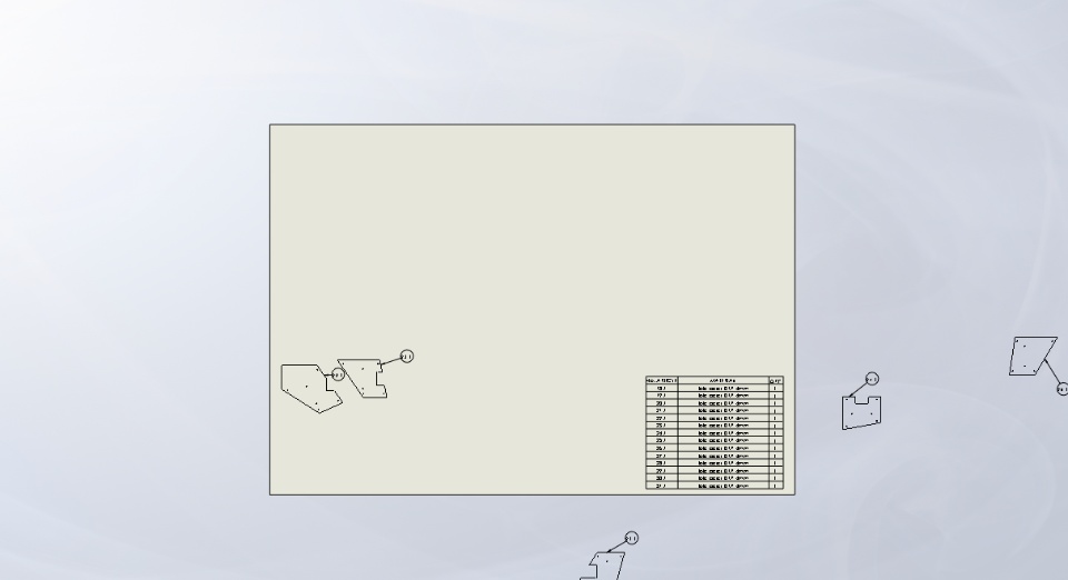

Hi,
I'm definitively losing my time since several weeks in manually arranging views in my drawing. I tried to write a macro but the view.position function doesn't seem to work. I found the SPR 682112 issue that sounds like my problem, but didn't succeed to find an alternate solution. Here is my code, does anyone can try it on any sheet with multiple views and check the result ? I'm running on SW2016 but can upgrade if necessary.
Before macro :
after running the macro :
The vpos array is really weird.
And if anyone has a solution ...

Sub arrange_views() '(swModel As SldWorks.ModelDoc2)
    Dim swModel As SldWorks.ModelDoc2
    Set swModel = swApp.ActiveDoc
    Set swDraw = swModel
    first_body = True
    marge = 0.02
    Set swView = swDraw.GetFirstView
    Set swView = swView.GetNextView
    Do While Not swView Is Nothing
        vNewPos = swView.Position
        vNewOutline = swView.GetOutline
        Debug.Print swView.Name & vbCrLf & "       position INITIALE " & " : min : (" & Round(vNewOutline(0) * 1000, 2) & " ; " & Round(vNewOutline(1) * 1000, 2) & ") | MAX : (" & Round(vNewOutline(2) * 1000, 2) & " ; " & Round(vNewOutline(3) * 1000, 2) & ")"
        If vNewOutline(2) - vNewOutline(0) < vNewOutline(3) - vNewOutline(1) Then 'if height > width then rotate
            bool = swModel.Extension.SelectByID2(swView.Name, "DRAWINGVIEW", 0, 0, 0, False, 0, Nothing, 0)
            bool = swModel.DrawingViewRotate(90 / 57.3) 'rotation de 90° (conversion degres/radians)
            swModel.GraphicsRedraw2
            Debug.Print "APRES ROTATION : min : (" & vNewOutline(0) & " ; " & vNewOutline(1) & ") | MAX : (" & vNewOutline(2) & " ; " & vNewOutline(3) & ")"
        End If
        If first_body = True Then 'initialisation pour la première vue
            vOutline = swView.GetOutline
            vOutline(1) = 0.277
            larg_col = vOutline(2)
        End If
        vNewPos(0) = marge + Abs(vNewOutline(2) - vNewOutline(0)) / 2 ' X centre de la vue à plat
        vNewPos(1) = vOutline(1) - Abs(vNewOutline(3) - vNewOutline(1)) / 2 'Y centre de la vue à plat
        swView.Position = vNewPos
        swDraw.SuppressView
        swDraw.UnsuppressView
        If vNewOutline(1) < 0.05 Then ' si la vue déborde en dessous de 50mm, déplacement dans la colonne suivante
            marge = larg_col
            vNewPos(0) = marge + (vNewOutline(2) - vNewOutline(0)) / 2 ' X centre de la vue à plat
            vNewPos(1) = 0.277 - (vNewOutline(3) - vNewOutline(1)) / 2 'Y centre de la vue à plat
        End If
        If larg_col < vNewOutline(2) Then larg_col = vNewOutline(2)
        vPos = swView.Position
        first_body = False
        Debug.Print "       position FINALE : min : (" & Round(vNewOutline(0) * 1000, 2) & " ; " & Round(vNewOutline(1) * 1000, 2) & ") | MAX : (" & Round(vNewOutline(2) * 1000, 2) & " ; " & Round(vNewOutline(3) * 1000, 2) & ")"
    Loop
End Sub
