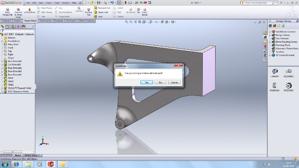

Are you trying to making a derived part?
I create part and save it as library feature (*.sldlfp) and position in the design library.
While dragging the library feature from the design library, I got a message like this "Are you trying to making a derived part".
And also i refer solidworks forum-search for the solution, i got a solution of RMB on the folder in the Design Library and check that it is a Forming Tools folder.
I assume it is used for sheetmetal forming only.

Yes, everything in the forming tool folder is meant for sheet metal parts only and extension is SLDFTP.
Seems like you may not have model the librray feature correct. Can you upload that SLDLFP and let someone check.

It seems like a smart component rather than a design library feature. Study the various design library feature under design library to understand more about them.
