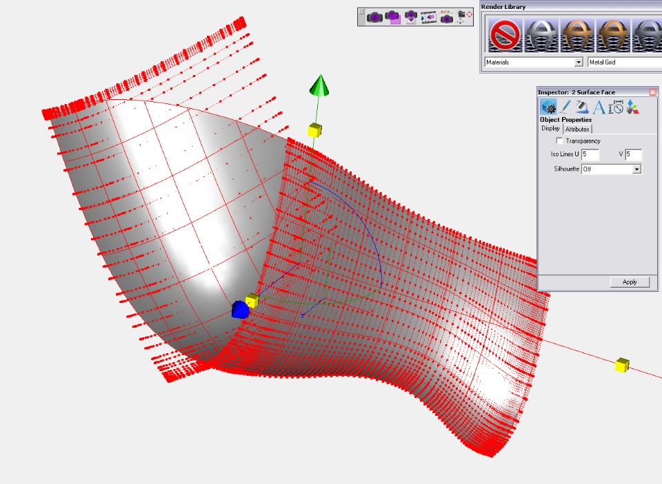

I was quite frankly horrified by the surfaces as imported into Alias. To create this particular object I used boundary surfaces and fills - all generated from a two point spline (so literally a point at the start and a point at the end, with directional and constraint controls) In SolidWorks the curves are smooth, the surfaces looked smooth and G2 continuous. In Alias they looked smooth on the shaded preview but the wires showed hundreds of UVs on the fill surface. We then remodelled the worst section of the product in Alias (his comment was - modelling in Alias is slower than Solidworks, but better in terms of quality). He spent some time setting up the curves, ensuring continuity then surfacing. The IGES file I exported from SolidWorks was 11MB. The IGES file from Alias was 300kb.

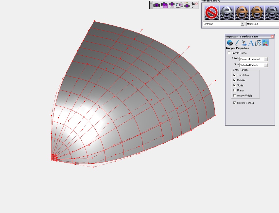

4. Display of surface internal points - this was the shocker! Just showing all the points showed up the density of points used by the fill surface and to some extent to the boundary surface. Again in Alias (and others) you can show surface control points as you shape it, adjusting the points to make the "flow" better.
