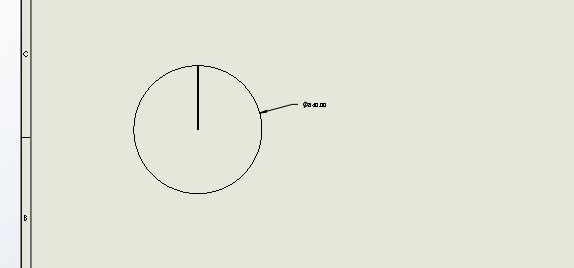

I'm my drawing sheet, I need to show an arc dimension. The arc is almost a full circle but with a small 1mm cut across 1 side as shown:

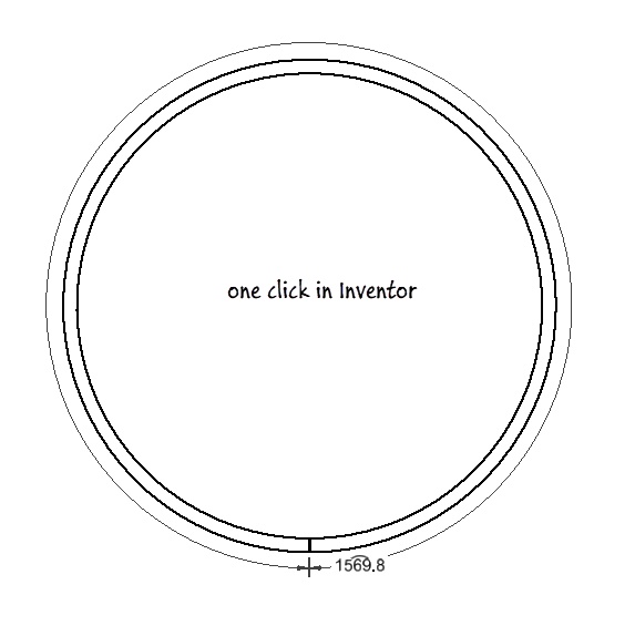

I get this very peculiar dimension that doesn't really represent anything. My points are at the bottom and yet, the dimension doesn't show the correct value nor are the points serving any purpose... I did the exact the same in Inventor with the exact same part (created in SW) and in 1 click, got exactly what I needed:
How can I get this result in Solidworks? My current method was to pick both points then select the curve.

NH 2017-05-17 Best Answer
I thought this could be easy but apparently not.
3 attempts
Path length dimension doesn't work on single entity.
Measure tool give arc lentgh which is no good if you have to change drawing all the time.
Good old fashion Math
Edit: V4 works
Be careful dragging Path length annotation cause when i dragged mine it moved somewhere and made drawing unusable, ie ultra zoomed out.

This has been a problem for an arc over 180° ever since I can remember with SW. What I do is select the edge and convert (in sketch tools.
Then select your arc ends and curve. Once you have done that you might have to drag the leaders slightly to get it to come out right.

Hi Nacho,
Move the cursor in between 2 points after you click on the arc to get the correct form of dimension. If you move the mouse pointer outside the 'slit' it'll show the dimension you are getting.
Pls see attached gif.
