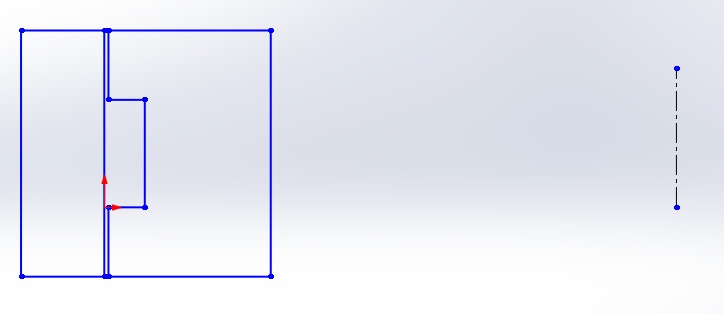

This has worked fine for most of the parts however, there is one component which is revolved as two separate closed sketches as shown below:
This causes problems as the faces on the left section of the revolved body do not seem to get names applied to them, only the faces on for the section sketched on the right do. I think this may have something to do with the split between two sketches resulting in SW thinking these are two separate bodies?? In which case, how could all faces be named?
