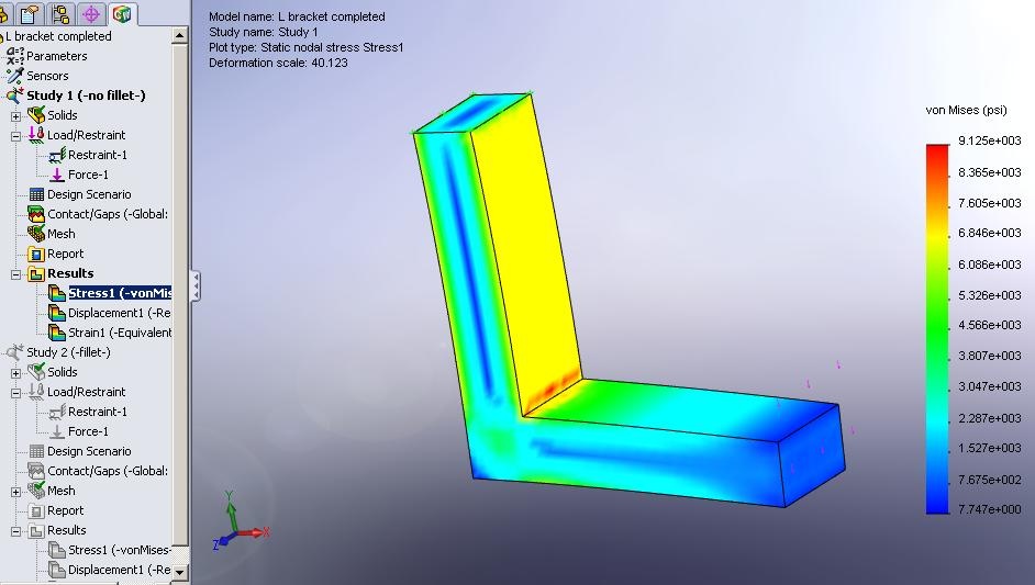

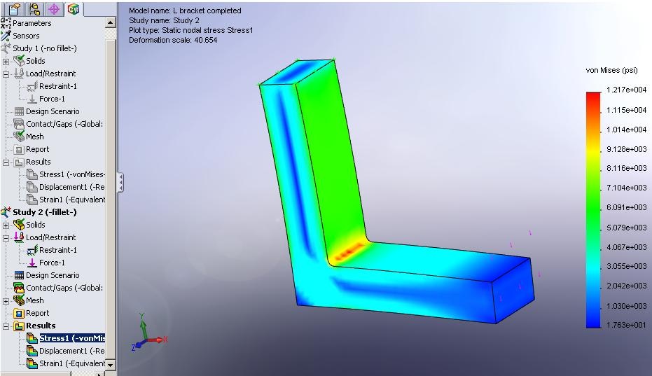

I am just studing the different configuration in cosmos works.
one doubt i have when i have taken a L bracket and analysis it, itcreates a stress of 4Xe4 psi.
but when i applying a fillet in the bracket, it will show maximumstreess.
according to theory during fillet stree will be develop less.
so what is the reason?
i am attaching some pictures for the refferences.SolidworksSimulation

If you see overall, you can see reduction in the stress. Tryincreasing the fillet and run the study again.
SF
SF 2008-12-30
yes i know that when i increase the fillet radius , stressvalue there by decreases.
it is true about the increasing radius of fillet.
but my question is wheather the stress is maximum in case of filletor without fillet.......

without fillet, you get something that is called stresssingularity.
Each time you refine your mesh, you will get a higher stress...
According to theory of elasticity, stress in such corners isinfinite and with cosmos you get a value because of the mesh thatis only a simplification of reality.
To sum up, without fillet, finite element methods cannot give anestimation of the stress.
With a fillet, stresses will be different, and if you refine yourmesh, you will converge to a value that is the correct stress.
