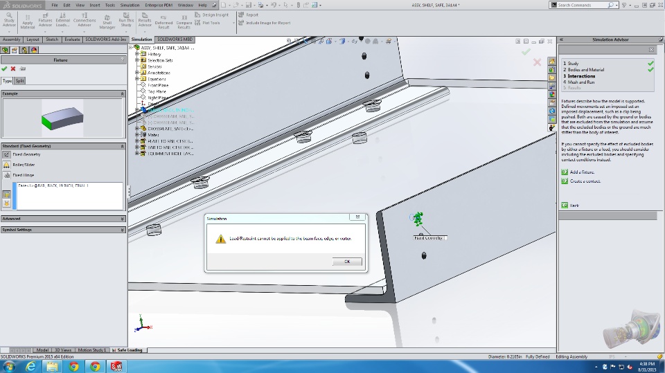

Hello,
I am trying to apply a fixed geometry to my assembly  where the bolt would go, and I keep getting this error.  A little bit of information about the assembly, the two rails are weldments, and the middle plate is a sheetmetal piece.  I have the "Treat as a solid" selected on every item I can, and yet when I try to add this fixture to the cylindrical face of the bolt hole, I cannot.  Anyone have any ideas?

Hi Jordan,
have you tried making a new study and redo your settings?
TL
TL 2015-09-01
by the way, when it is a hole for a bolt, i think the fixed geometry is not the right fixture for your calculation

Hi Jordan,
You are using a BEAM element. That is a simplified element that doesn't allow you to fix it like that.
2 options:
  • Change the beam element to SOLID or SHELL (right click on the part in the tree, select 'treat as solid'). This will increase computational time
  • Fix the BEAM on the purple or green dot

My excuse, I see you allready have selected 'Treat as Solid'. Apparently it still sees the model as a Beam. I agree with ​ that setting up you study again might help.
What version are you using?

Thanks for the responses everyone!  Yeah, I couldn't figure this one out either.  I have temporarily got the simulation study to work, but I had to take my weldment study and use the "Save Bodies" feature in solidworks, and save it to a separate file, and then reconstruct my assembly for the study with the new file.  Seems likethe "Not the right way to do it" way, but I have to do something to get this thing to work. ha.

Hi Jordan,
Have you tried meshing the study first then applying the fixture? the fixture has to map on to the nodes so the mesh may be out of date and still think the element is a beam.
