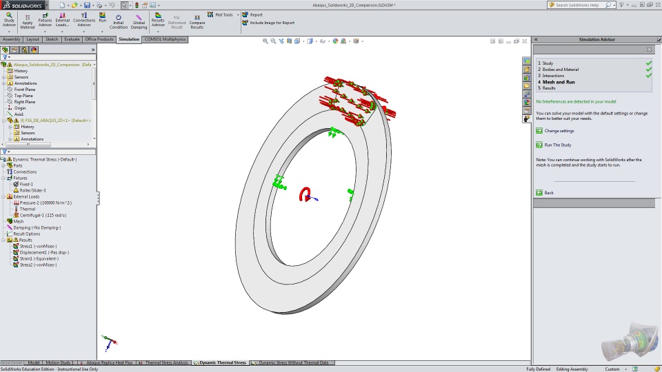

I am trying to analyze the stress distribution for a brake disc when pressure is applied to it via brake pads.
I have created a very simple model in the form of an annular ring and have begun to set up studies to analyze this.

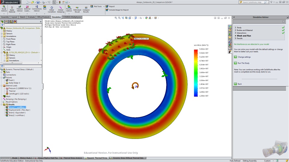

My issue with the study is that I want to rotate the disc through the region in which the pressure is applied, instead of rotating the pressure and the disc simultaneously. The pressure applied to the disc is confined within a split line that I have created in the shape of the brake pad.
I have fixed the inner radius of the disc, and applied a rolling/sliding fixture on the face opposite to where the pressure is applied. I have applied a centrifugal load to the disc to give it an angular velocity, however this is not apparent when animating the model.
I have attached some images below for clarity, I am not sure if what I am asking is achievable within SolidWorks however any insight to this would be greatly appreciated.

What does it look like if you section the disc on each side of the brake pad?
I would assume that a radial section would show one side to be in tension (rotating away from pad) and the other in compression (rotating toward pad).

solidworks simulation is a linear static analysis
ie, there is no rotation, centrifugal load is a body load, it isn't actually rotating the part
you need to break your problem into a linear static analysis (basically what you have minus centrifugal) or move to nonlinear dynamic (not recommended)

Personally, I would attack this backwards.  You know the applied force from each brake pad.  I hope you know the friction coefficient.  F x mu = friction force, therefore if you apply a radial force of that magnitude, parallel to the surface, on each of the split surfaces while holding the hub stationary then you should see the stress induced in the disc.
My thought is assuming constant braking force and this would be the instant before it stopped completely.  Is that what you are 'driving' at?
