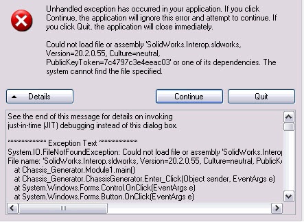

I have a program that I wrote in Visual Studio Express 2012.  The exe file works fine when I run it with 64 bit solidworks.  I open the exe, the form opens up, I enter my information, and SolidWorks does what it needs to do.  When I try to run the program on another computer with 32 bit solidworks, the form opens, but once I hit enter for the form to call my module that connects to SolidWorks, the program errors out.  The project is using .NET Framework 3.5 and the target CPU is set to x86.  The program connects to SolidWorks with Dim swApp as SldWorks = GetObject(, "Sldworks.Application")

************** Exception Text **************
System.IO.FileNotFoundException: Could not load file or assembly 'SolidWorks.Interop.sldworks, Version=20.2.0.55, Culture=neutral, PublicKeyToken=7c4797c3e4eeac03' or one of its dependencies. The system cannot find the file specified.
File name: 'SolidWorks.Interop.sldworks, Version=20.2.0.55, Culture=neutral, PublicKeyToken=7c4797c3e4eeac03'
at Test.Module1.main()
