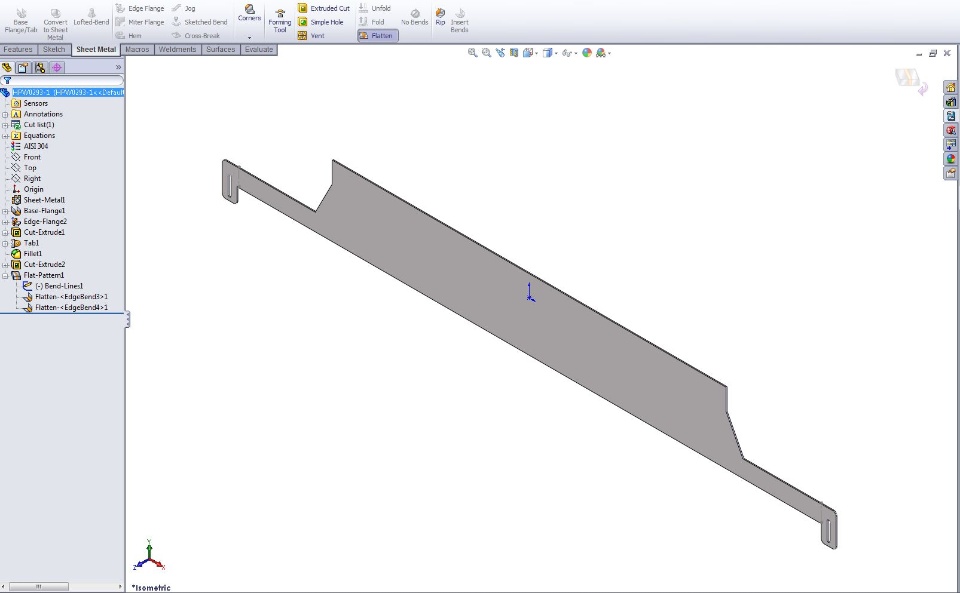

Test 1: Using built in SW sheetmetel flatten button
     Step 1: Open part
     Step 2: Click sheetmetel flatten button
     Result: Everything behaves normally as expected and the part flattens.

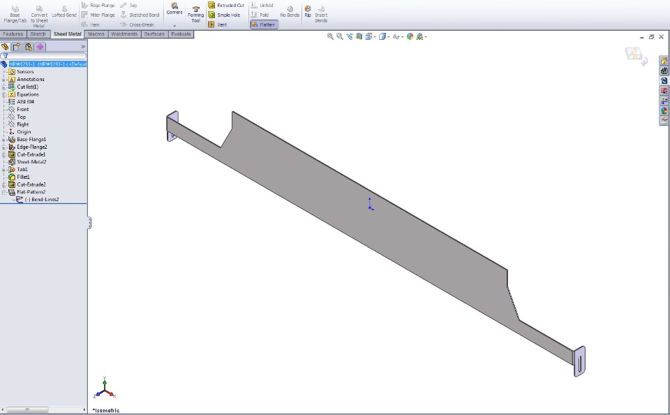

Test 2: Using attached macro "flatten sheetmetel part".
     Step 1: Open part
     Step 2: Run macro
     Result: SM flatten button looks to be activated but the part is not flattened. The name of the flat pattern has now also changed from Flat-Pattern1 from Flat-Pattern2.

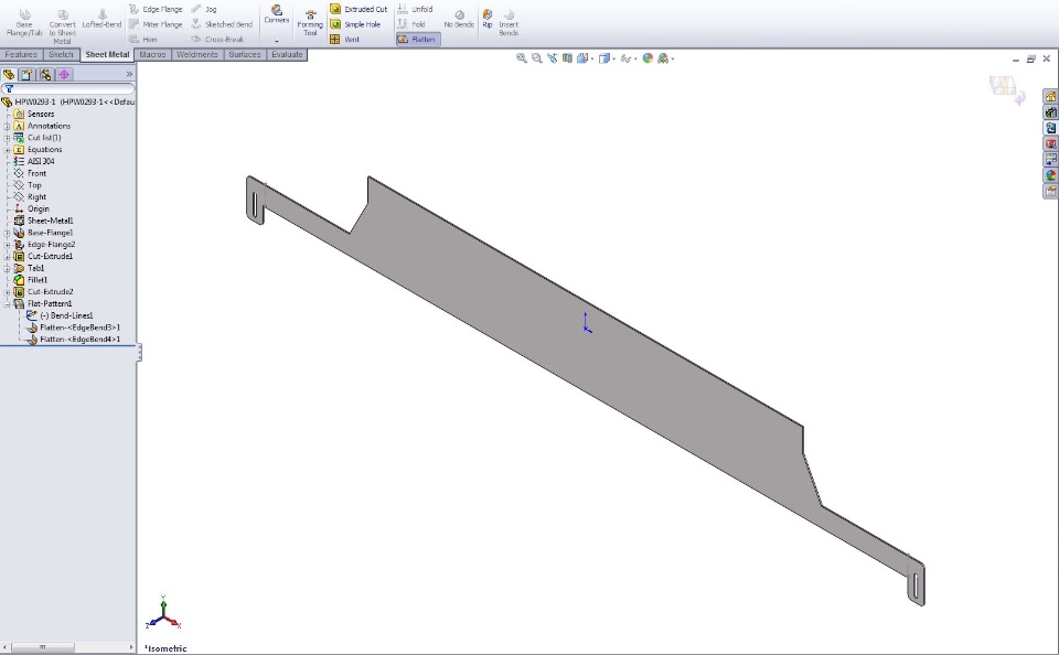

Test 3: Modify EditRebuild3 to be ForceRebuild3 and run the rebuild twice.
     BendState = swModel.SetBendState(swSMBendState_e.swSMBendStateFlattened)
     bRebuild = swModel.ForceRebuild3(False)
     Step 1: Open part
     Step 2: Run macro but debug pause before the second rebuild
     Step 3: Run second rebuild.
     Result: After first rebuild everything appears to be the same as Test 2 with the name changing to Flat-Patten2 and the part not flattening but then once the second rebuild is run the name corrects itself and the part flattens.

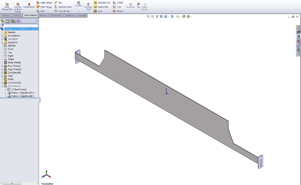

I have tried it in SW 2013 SP5 and it does not work on my computer, results below. The code below does not work but the built in flatten button does. If you record a macro of one clicking the button it gives the exact same code below but when run in a macro it creates a new Flat-Patten feature as per image 1.
bRebuild = swModel.EditRebuild3()
Macro run, new flat-patten feature is created and visible in tree (this was not the case in 2010 and per original post)
Clicking the flatten button, everything works fine.
