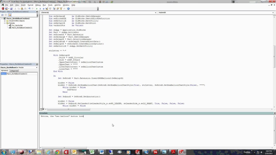

See the attached video for a demo of this bug and the steps to reproduce.
I just reported this to my VAR.
Wondering if anyone else can reproduce this.
Bug Description:
Seemingly randomly (e.g. sometimes the call completes successfully 20+ times in a row, sometimes it happens on the first attempt) the call to InsertBOMBalloon2 will fail to execute properly. What happens is the balloon won't be created, but what I notice is that in the UI window the "new balloon" command button enters the pressed state and sticks there.
Every time this happens, Solidworks crashes if I try to click back to the UI window. Every time - repeatably.
Has anyone else noticed this, or can anyone else reproduce?
< P.S.> I don't know what is going on behind the scenes with the InsertBOMBalloon2 procedure, but I think it's odd that the button press animation is fired at all.
