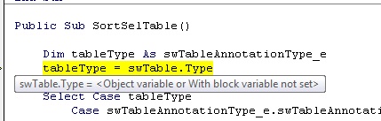

Anyone use the new sorting function in 2012?
I've been trying to get the example from the help files to work and I keep getting an error that my limited skill set cannot figure out.  Any thoughts?  I'm trying to sort a BOM table on a drawing that was created in 2011 but updated with 2012.

Here's the drawing.
