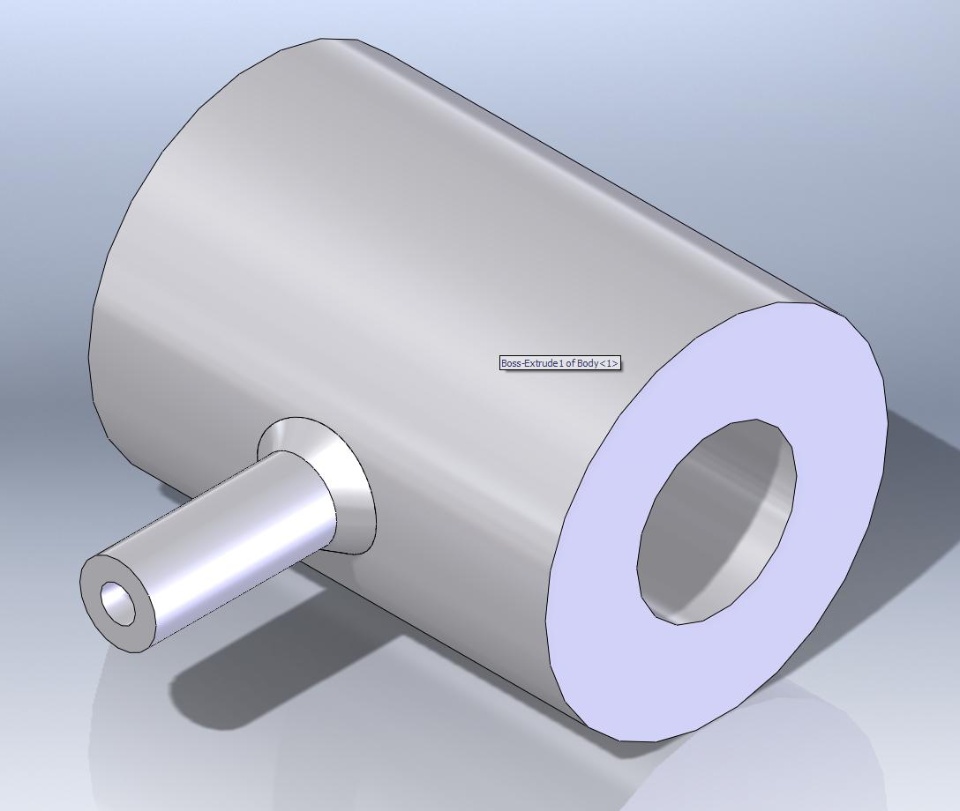

I am looking for some advice on the best/easiest way of creating a weld in a SolidWorks assembly.
The attached assembly has a body which is drilled and profiled (at the assembly stage), then a pipe is welded to it.
Because the body surface being welded to is not flat, a simple revolved weld feature does not work.
I have to use a swept profile and a 3D guide curve so that the weld follows the body shape all the way around.
Although this method works, it is very time consuming and seems overkill for a simple weld!
Any ideas as how I can simplify this would be greatly appreciated.
