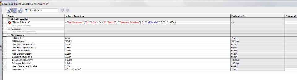

Just for completeness, here's the way to do it with VBA in equations rather than the design table.  It's a bit more cumbersome to set up for each dimension, but it recalculates the tolerance values with every rebuild rather than having to open the design table.
This is the equation to set the symmetric tolerance value of D1@Sketch1 to 10% of its value.
"dummy"= Part.Parameter("D1" & Chr(64) & "Sketch1").Tolerance.SetValues(0,"D1@Sketch1"*0.1/1000)
Just to break it down a bit:
"dummy" is nothing.  It's just a dummy variable that's required to make this code fit the syntax of a SolidWorks equation.  The equation has to have something on the left side of the "=".  It could be anything.
Part.Parameter("D1" & Chr(64) & "Sketch1") specifies to SolidWorks which dimension whose tolerance we want to control.  In this case, we are working on D1@Sketch1 .  In order for the code to work, you have to break up the name of the dimension and replace each @ sign with Chr(64).  The & is the string concatenation operator.
.Tolerance.SetValues tells SW that we want to set the values of the tolerance of the dimension.
(0, is the lower tolerance limit value followed by a comma to separate it from the upper tolerance value.  In the case of symmetric tolerance, the lower value is ignored.  However, if you wanted to set a bilateral tolerance value, you would specify the lower limit here.
"D1@Sketch1"*0.1/1000) is the upper tolerance value.  Remember when we had to break up the dimension name and replace @ signs with Chr(64)?  That's because before SW sends this code to VBA for evaluation, it looks through the code for special strings.  Dimension names inside of quotes are one those special strings.  Whenever SW finds the special strings, it substitutes the numerical value before passing the code on to VBA.  So, if the value of D1@Sketch1 is 864mm, VBA will see 864*0.1/1000.  The *0.1 gets us 10% of that value.  The /1000 is a scale factor to go from mm (my document units) to meters (SolidWorks system units).  No matter what your document units are, SetValues requires input in meters.

Finally got to try this tonight. It works so sweet. Can you recommend a source to reference VBA for a VBA ignorant person like me...so powerful and i know nothing about it!!
BTW for inch users:
"dummy"= Part.Parameter("D1" & Chr(64) & "Sketch1").Tolerance.SetValues(0,"D1@Sketch1"*0.1/.0254)

JD 2012-05-01
Josh,
I hope you read this. This wonderful tool you gave me seems to no longer work with the "upgraded" equation manager. Tells me the syntax is wrong. Any ideas anyone?
Josh,
comment imagecomment image
