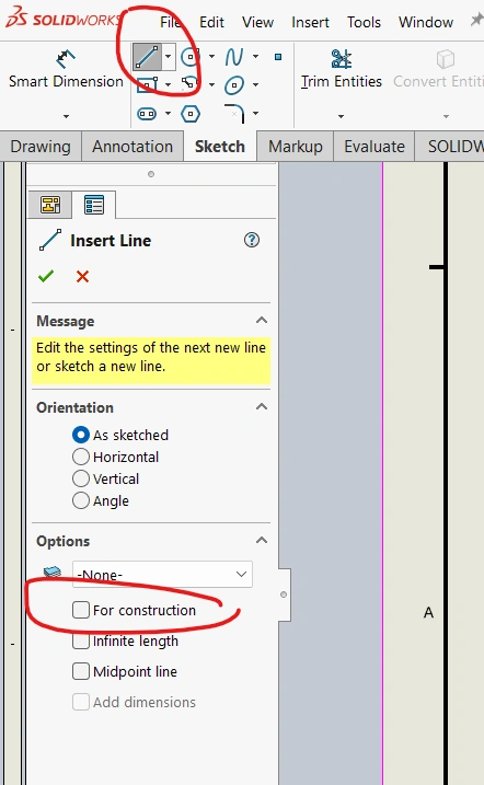

Any reason why is the circle command does not have ‘For construction’ whereas the line command does.
Hi,

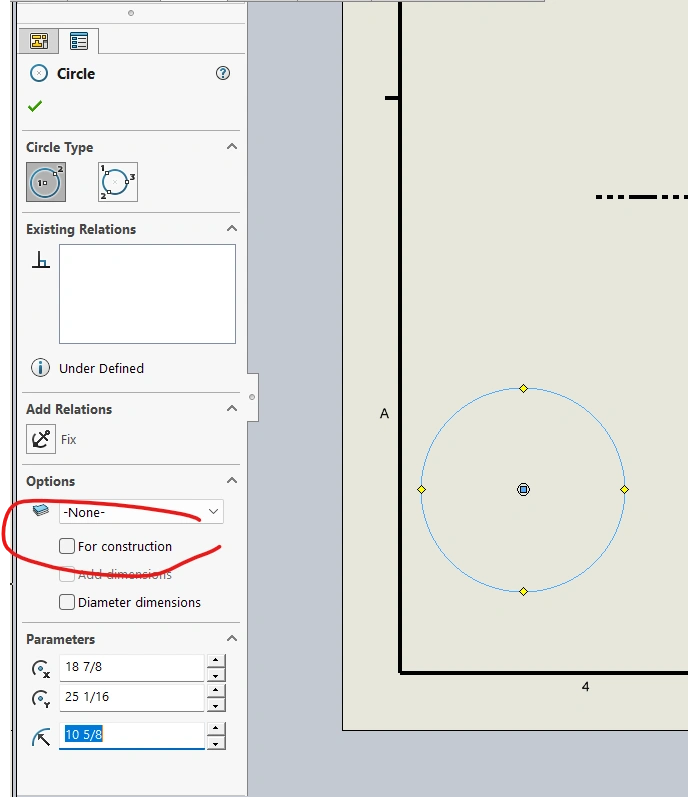

You can see "For construction" option after creating circle sketch entities,

Which version of SW are you showing?
My SW2021 has it. It's not shown until you click its center point and then it's grayed until there's a radius. Then you can check it. But it's still during a circle's creation.
Same for SW2024, whether you're in a drawing or a sketch.

I believe OP would like to have the option to have the circle be construction before placing it, similar to the way we can with straight lines, instead of making it construction after placing it.
I am not aware of any way to do this, by the way.

The checkbox activates the command Tools > Sketch Tools > Construction Geometry. You can bind this to a keyboard shortcut or mouse gesture if you find yourself using this a lot.
