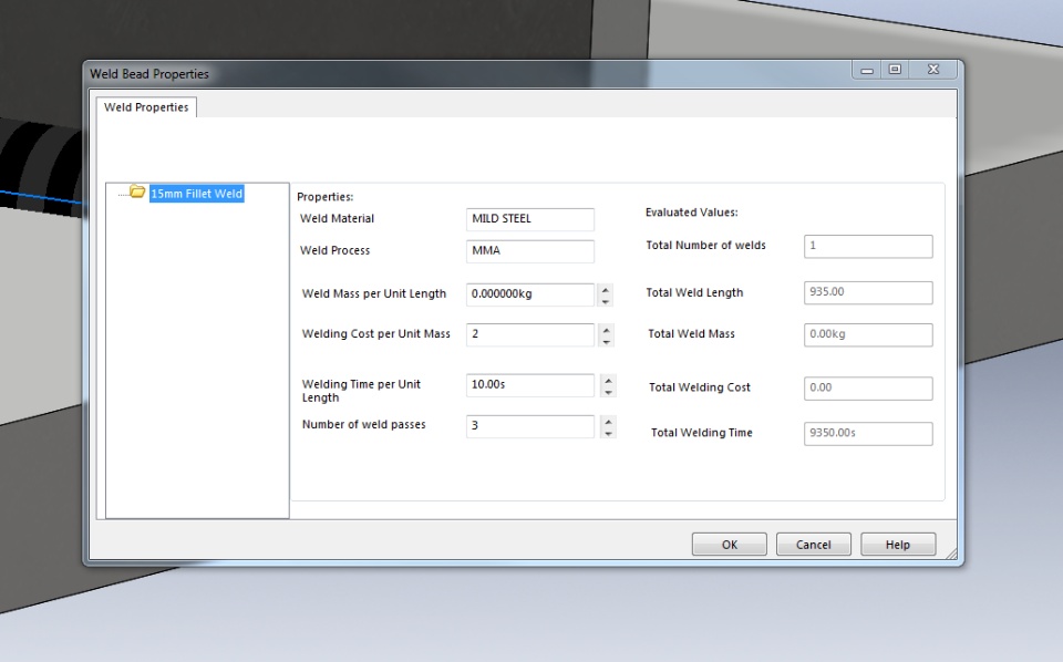

Any one fill these in in the weld bead properties
As the question askes does any one use the weld bead option and do you fill in the boxes?
Never used it before, only ever detail welds in the drawing.
Now looking to use it for a small sub assembly to try and work out total length of weld used and how much extra it adds to the weight. and also time / cost.
What do I put in for weld mass per unit length (what is classed as unit length)?
Same as above but for cost per unit mass.
Does anyone have a screen shot of these filled in with a brief explanation of each.

Hi Glenn,
That link leads me to a conversation we had from last year, haven't looked at weld beads until today.
Just tried inserting a weld table into a drawing and I get the weld length shown in the table.
Not sure if this is what you wanted to see.
Thanks
Mark

Hi Glenn,
So it seems that over a year later the weld bead function still isn't that good in SolidWorks.
Oh well, I will just continue detailing any drawings rather than using this function.
Still surprised that no one has posted on how to fill the info in as per my original question.
Does no one use the weld bead??
