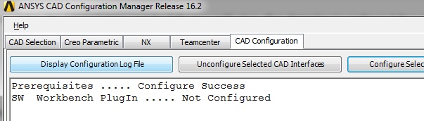

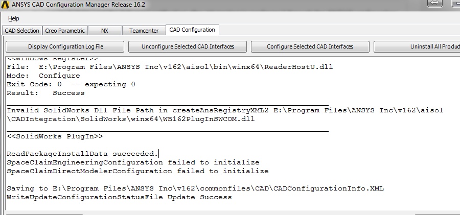

Hey guys, im trying to enable workbench ANSYS add in for solidworks. When i follow the required steps i get the following notification after attempting to configure it through the ANSYS configuration manager;
"Prerequisites ..... Configure Success
SW  Workbench PlugIn ..... Not Configured"
The add in obviously does not appear after i receive this message... has anyone encountered this error before and knows how to solve it??
I have put screenshots of it bellow.
Thanks!

DL 2015-10-21 Best Answer
I never did get the Ansys configuration manager working properly.  I just check the box to install the add-in during the main Ansys installation process and it seems to work.

Ahh well thanks for the help Dave, really appreciate it! Is there a way to import the solidworks model into workbench without the plugin?
DL
DL 2015-10-21
Saving out of SolidWorks as an IGES / STEP and then importing that from inside DesignModeler should work.  Unless you were planning on using parameterisation then it'll be the same end result.
Only other thing might be to open DesignModeler, then go File > Import External Geometry File.  I see SolidWorks as an available import file option in the dropdown in that window but I don't know if that's because I've got the translation tool installed.
