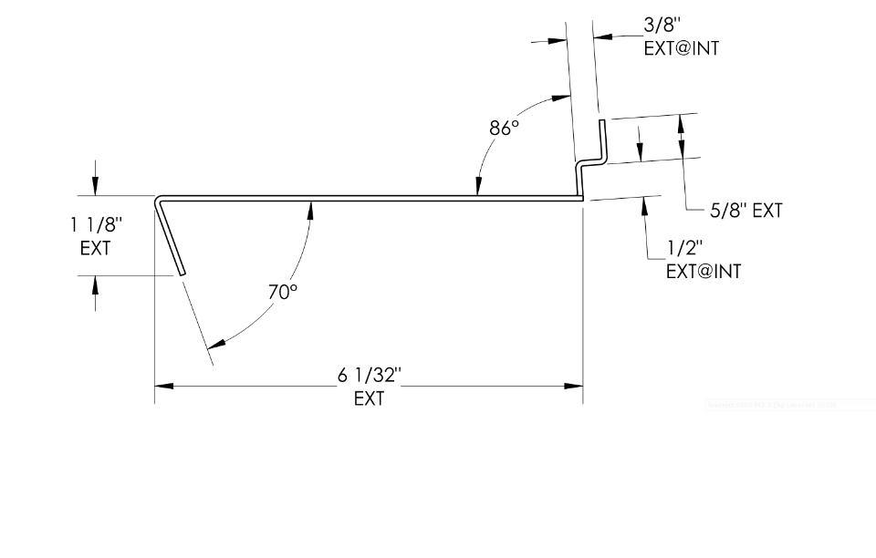

I would like to know if you guys use annotations and suffixes to the dimensions on the drawings.
If so, which one do you use and when do you use them?
Here is the list of the ones we use internally.
Thanks,
Martin
O/C → Outside to Center
C/C → Center to Center
MIN → Minimum
MAX → Maximum
INT → Interior
EXT → Exterior
TAN → Tangent
INT@EXT → Interior @ Exterior (for bends)
APEX → APEX
REF → REFERENCE
TYP() → TYPICAL

Once in a while TYP, but never ref as I use the () instead.  The others in your list, not at all as our dims are usually clear enough without extra notations.

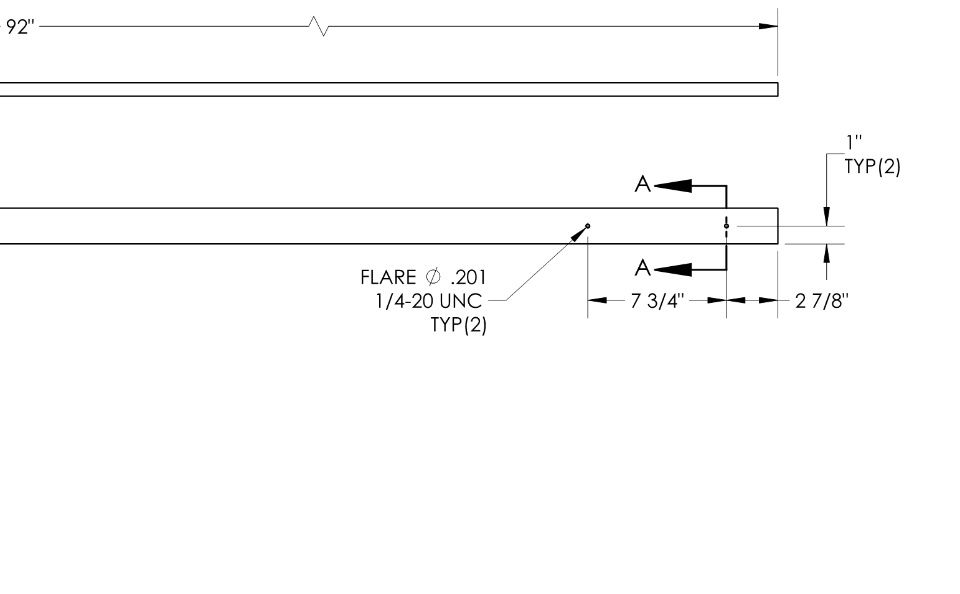

Hi Wayne,
When you use the annotation TYP do you add the QTY in ( )?
Ex.TYP(4)

we use () for reference dimensions and a prefix like "2X" for multiple places.
otherwise we probably only have these:
T.S.C. = Theoretical Sharp Corner
O.R. = Over Radius

I usually use TYP x 4.  I think that's the only one from your list that I use.

Not consistently as sometimes it's obvious where they are and the intent is all of them.  When it helps clarify something, then yes.
