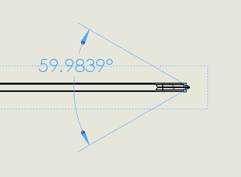

Is there a way to show an angular dimension as the "Want This,png" file shows, which was achieved with AutoCAD?
The "Not This.png" file shows the result I got with SW 2011 sp3. I couldn't find a way to "flip" the dimension.

You could sketch 2 lines coincident with your existing lines and dimension to them.  It may be tedious, and there may be a better way, but it will work.

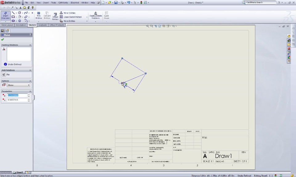

Use the three points starting at the point and then then two end points.  see the attached video

Timothy,
Your answer worked like I wanted.
The only problem was after picking the first two points, it shows the text and arrows of the dimension (as expected)
it makes it hard to pick the 3rd point because the text is blocking my view of what's under the cursor.
But I did manage to find it. Thanks. Your answer is marked correct.
