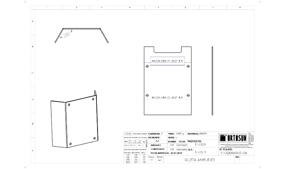

Someone knows how to change the note that apears in drawings of a sheet metal part:
- when i introduce a view expand of this part, appear the note of angle of bend and and if it is up or down.
- i need to change the angle to the complementary angle
I will be very grateful if someone could help me.

Good morning Carlos,
I don't know how you can change the SW generated note, however you could change your dimension to show the 60 degrees.
The other thing you can do is click on the the SW generated dimension and in the note section you can choose to attach an arrow or not, click on the arrow with X icon and then drag the dimension off the drawing and add your own note.
If that doesn't make sense let me know and I'll try to get a few pictures of what I mean,
Later,
John
