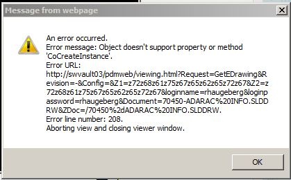

An Error Ocurred. CoCreateInstance Windows 7 and IE 9
I downloaded and installed E-Viewer 2012 32 bit for a 32 bit Windows 7 computer.
When I click on a Solid Works PDM SLDDRW file link in pdmweb, I get the attached error.
It does not happen on 64bit installs.
I have a workaround to uninstall eViewer 2012 and install eViewer 2010.
Any one have thoughts on this?

Ummm, I think you may have posted the wrong image.
And it sounds like you have downloaded the wrong version of eDrawing Viewer

Well THAT"S embarassing... I updated the image.
I replicated the error on 2 different PC's. Unless the download link is wrong, it's the correct 2012 eViewer.

Hmmm, I see there is no CoCreate version, so i doubt it's the wrong download.
Do you have or have you ever had a CoCreate (or OneSpace or Creo) product on your machines?

No Sir. No OneSpace nor Creo. These machines have a clean build of Windows 7. I think it may have something to do with installing eViewer 2012. Although I unistalled it, and installed 2010 (which works fine on all other computers) I think there is a residual setting or registery entry that is preventing the eviewer window from opening.

My solution was to do a clean unistall of SolidWorks v 2012 (per http://symsolutions.com/wordpress/2010/06/clean-uninstall-of-solidworks ) and I then installed v 2010.
I no longer receive the error and the drawings pop up as expected.
