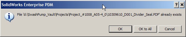

Trying to add several pdf's to the vault and keep getting "already exists" error.
Things I've tried
Logged on as admin destroyed all deleted files from the vault.
searched the vault for file of same name - none exist
EPDM 2009 SP5

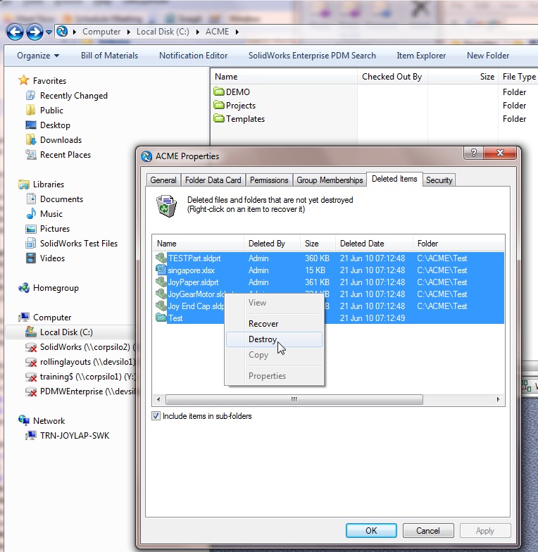

John -
Check the recycle bin.
Place you cursor in the file view at the root level of the vault, RMB and select Properties and select the Delete Items tab.
Check 'Include items in sub-folders'.
To fully delete, select all the files and folders, RMB and select Delete. (see image)
Usually users delete files and forget to 'Destroy' them to completely remove them.
Regards,
Joy

Hi Joy
Thanks for the response.
As stated in my original post, I have destroyed all deleted files and folders. Including items in sub folders.
Still can't add those files.
