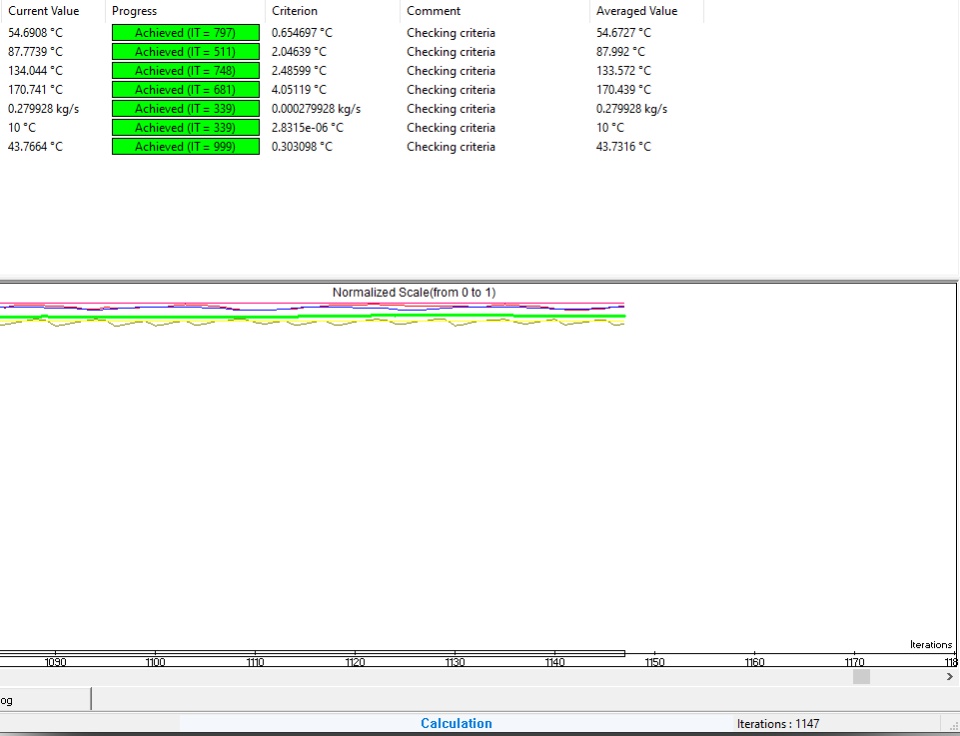

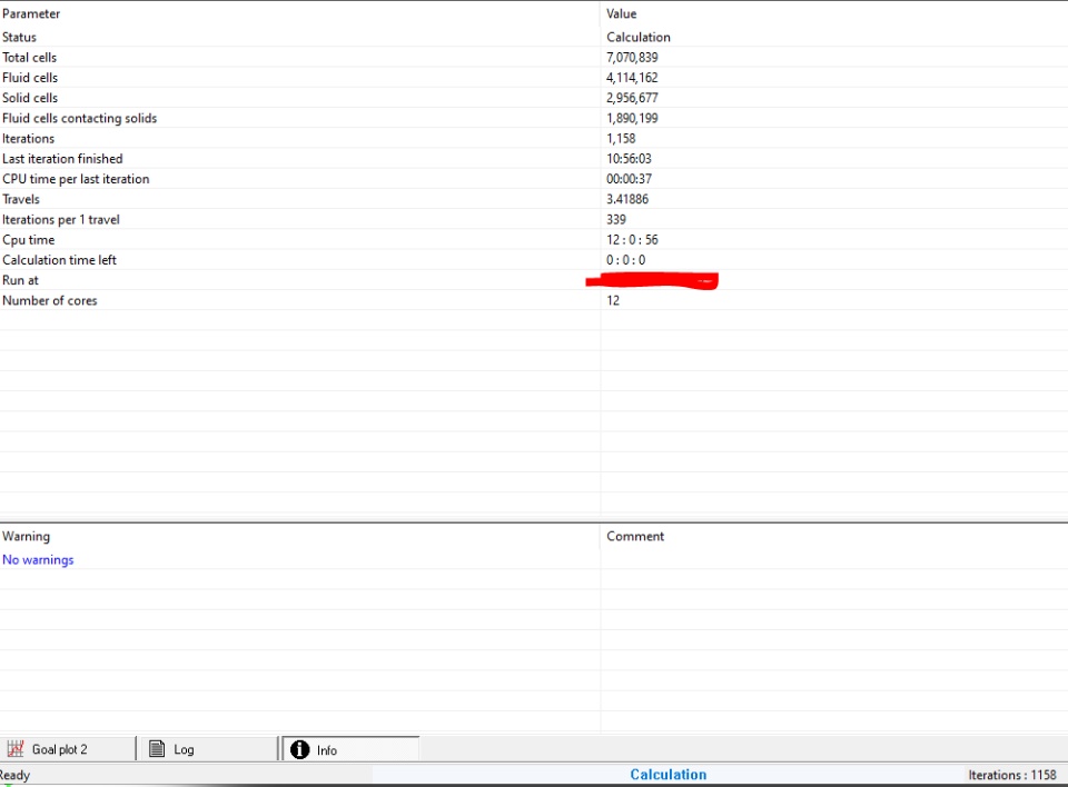

I left a complicated flow sim running at 10PM last night. This morning I came to find that the simulation has reached every goal, horay. However, the iteration seems to continue. Everything appears healthy and the info tab shows no warnings. Should I be concerned or is this a normal phenomenon? All goal criteria are set to auto by default..

This might be the response from options set in this project's Calculation Control Options.  To check, right click on 'Input Data' at the top of the Flow Project Tree and select 'Calculation Control Options'.  Do you have any of the options for "Iterations", "Travels", or "Calculation Time" turned on and set to some high value?

I think the issue stems from not having anything enabled under "Finish Conditions".  I would suggest turning on "Goals convergence" and setting it to "All Goals" then seeing if the solver does not then stop when all goals are met.  This might be something you do for future solver runs.
Since all your goals are converged currently, you can stop the solver manually as you have arrived at the goal converged solution already.

All are unchecked. Is it advisable to check iterations and set it the current number of iterations to induce the stop?
EDIT: I think I found the fix. Under finish condition, goals convergence is unchecked and set to for information only...
Thanks for the help!!
