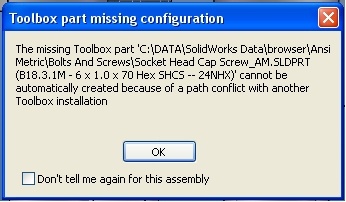

I have an assembly in which i have inserted some fastnersfrom toolbox.
i have save it and close it...
next day when i have opened the assembly i am getting an errormessage(see attached image)
by pressing ok to this message the all fastners become same size.
What shoud i do???????????
Please help.SolidworksAssemblies
Check you toolbox installation folder if is it on local drive or ona common server. SW is not able to locate the required fastener andreplaced it with the one which is available in memory.
I could not understand what you trying to say.
How can i know the toolbox installtion folder ???
I think that Deepak wants to you check the UNC path of your toolboxinstallation (c:\SolidWorks\Data.....) something like that.
Is it placed locally on your machine or is it placed on a network?
Is your installation made from an image? or directly from a dvd ordownload?
is it possible you have more then one toolbox installed on yoursystem?
Or have an OLD toolbox placed somewhere?
