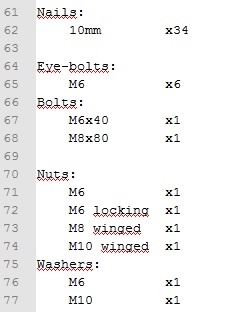

In SW2015, I'm trying to set up formatted text in Drawing Notes which has some indents in lines, like here:
(Screenshot from Notepad++)
But I can't seem to achieve the same thing in Drawing Notes. Pressing "Indent" creates indent at the start of each line, not from the cursor. I simply want to align parts of these lines like in this screenshot. In Word, for example, you simply press Tab key to achieve that.
How do I do the same thing in Solidworks Drawing Notes?

Select the lines you want to affect, then use the Paragraph Properties dialog.  It gives you the ability to set indentations from a common far-left edge of the note.  This will allow you to align the start of your individual paragraphs.  However, to get alignment of the quantity column, this will require that you use a font where each letter is the same width, or to use a table.
[Edit]  In the case of your list above, this is a BOM, and should really be in table format.  There is a function where you can insert a BOM under Insert>Table>Bill of Material, assuming you have a model from which you are working.

I tried that, but Notepad++ allows Tab'ing, and when I copy such text into SW, indents mess up.

Ah.  I typically use jEdit, not Notepad++.  jEdit has an option that emulates tabs with spaces, so when I cut and paste into SW it preserves the formatting.

That's very useful. But I'll have to use monospace fonts anyway in those Notes.
