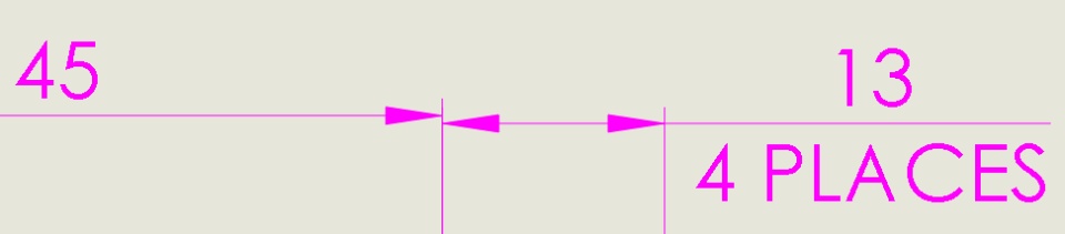

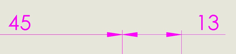

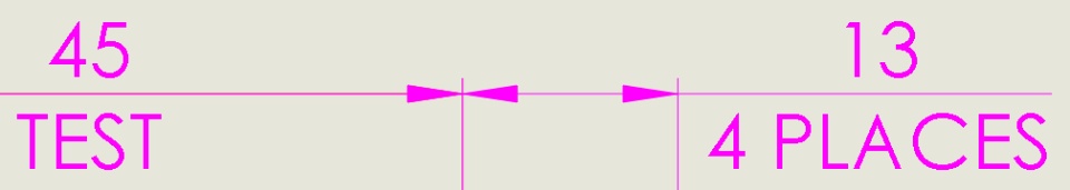

When I'm aligning text co linear it works perfect if i have no text under both dimension lines (see attachment 1) or if i have text below both dimension lines (see attachment 3.)
But when I have one dimension line with text below and the other just text above then it doesn't allow me to perfectly align the dimensions (see attachment 2.).
Is there away I can get the arrows to be co linear??

Hey Jonathan.. That is annoying.. you could put a blank space under the one's without..
