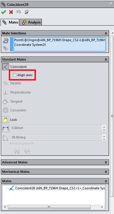

I’m working on Solidworks 2014 and am trying to make a mate between a component and a coordinate system within an assembly.
The manual way to do it is to select the origin on the component and the coordinate system and click mate, then ensure Align Axes is selected.
When I create the mate programmatically in C# after selection (using 1 as the mark) does not select Align Axes:

Any version of the align type:
swMateAlign_e.swMateAlignANTI_ALIGNED
swMateAlign_e.swMateAlignALIGNED
swMateAlign_e.swMateAlignCLOSEST
or switching flip does not select align axes.
I tried to change the mate type to coordinate system however it gives an invalid selection error.
