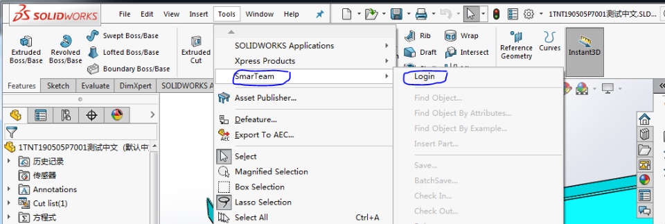

after use english menu the chinese char changed to question mark.
before use english lauguage menus
after use english lauguage menus

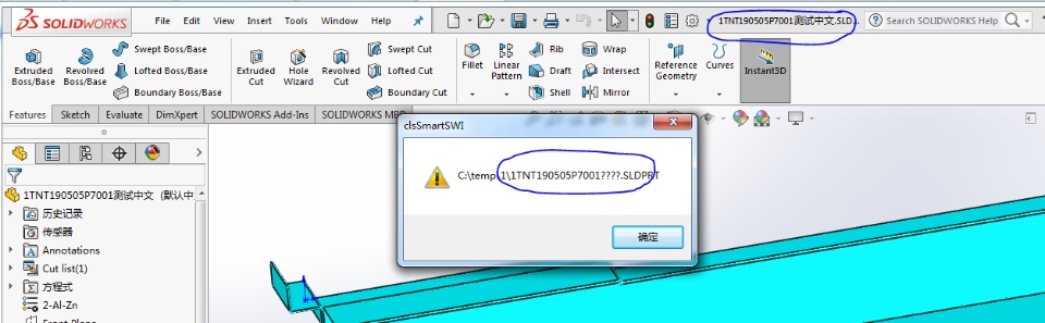

the chinese charactor become to quantion mark.
the operations step:
open sw part;
click plugin menu developed by me(like below);
output the message above;
the program code:
HRESULT res;
IModelDoc2* pModelDoc = NULL;
res = m_iSldWorks->get_IActiveDoc2(&pModelDoc);
BSTR bFilePath=StringToBSTR("");
pModelDoc->GetPathName(&bFilePath);
CString FilePath(bFilePath);
AfxMessageBox(FilePath);
