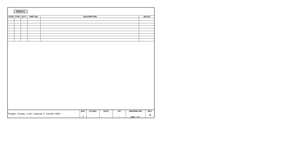

Here's our Excel template for reference.
