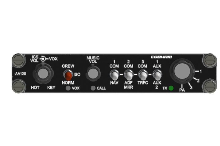

What's the best way to add text to the attached image other then cutting it out of the .sldprt?
I'm very new at this and doing ok until I tried to get the text to show. I inserted it as a block in the assembly file but that doesn't show up in PV360.
Any help would be greatly appreciated. I'm running 2010 version of everything.

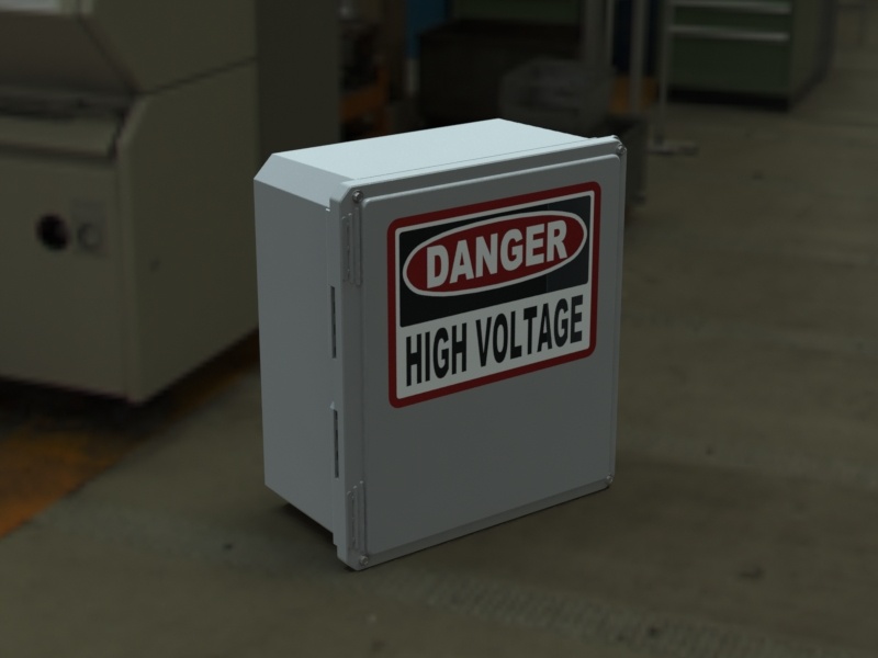

You can make a high-res decal that will fit perfectly over your features.
To make a face-plate for a tester I opened the silkscreen drawing in AutoCAD
-used the add-a-plotter wizard to create a PNG Raster driver
-created a custom paper size where the dimensions were the size of the face plate * the  resolution of the image.(DPI)
-opened the AutoCAD drawing and drew the frame around the text.
-printed the drawing to the raster driver using the custom paper size  I set the text color to 255 (otherwise it prints black) and changed the default back-ground colour to black..
Then in Solidworks I was able to insert the image as a decal onto the face and not have to tweak any of the transforms (position, scale, rotation)
To remove the black backtground I specified the image-based mask file option (works better than choosing the transparent color because there's always some feathering) and picked the same image.
The nice thing about decals is that you can specify surface finishes like matte or paint right there in the dialog box-in the end, I like them better than extruded text for complex silkscreens because you don't have the rebuild times and you don't get heavey black lines (from the extrude depth) around the text in the drawing.

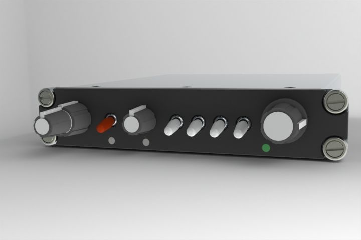

Let's see the result.
And tell us about your decal settings
SF
SF 2010-06-01
sorry, got busy on something else. I think it turned out quite well for a first time. The decal approach was easy. I did it just as suggested above, created a page the same size as my panel so no scaling involved.

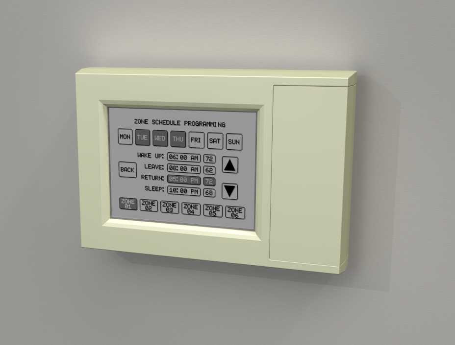

I do something similar, but it's a  bit more complicated.
I'll build the the part in SW and then create a  drawing of the face I want to add the decal to.
Save it out as a DWG file.
Then go  into autoCAD, and set up all the text and lines, etc. Make sure to make  closed polylines around everything I want to be a filled color.
Save that  file and then go into Adobe Illustrator and import the modified DWG  file. Then I do all the coloring, and then export that as a 300dpi jpg  file.
This  file I use in SW to make the decal on the part.
I know it's a  long process, but I can get some stunning rendered parts using this  approach.
