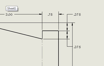

I'm not sure I'm asking this the right way, so if it's been posted before please point me in the right direction, but, I have a drawing of a sheet metal part where I use the Insert-->Model Items... to insert drawing dimensions.  I wanted to append the text "(TYP)" to a few of the dimensions, but the "Dimension Text" dialog box is greyed out. so I found the only way to do this was to check the "Override value:" checkbox.  Since the part is parametric, I didn't want to have to do this every time, so I added the text to the sketch dimensions hoping they would come in but they didn't.  Is there a way to do this, or are my only options to override the value, or add my own dimensions?
Here's the Sketch, and the drawing:

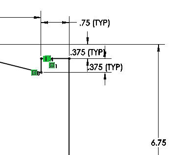

Can you not use this way of doing it?
comment imagecomment image
TC
TC 2010-09-09
Yep that did the trick!  So that's what clicking this little icon does:
Been a while since I've been into SolidWorks - thanks for the help!

Todd,
  The reason your text box is disabled is because the active configuration in your model is not the same as the one that you are doing your drawing of.  If you switch the active configuration of your model to the one you are doing the drawing of then the text box will be available.  Also, this is probably why your text in the sketch didn't show up in the dimension as you expected.
  The dimension palette gives you access regardless of the model's active config (don't ask me why, just use it to your advantage).  Also, you don't have to click on the icon, the box expands on rollover.
  Side note: NEVER use the Override Value checkbox
