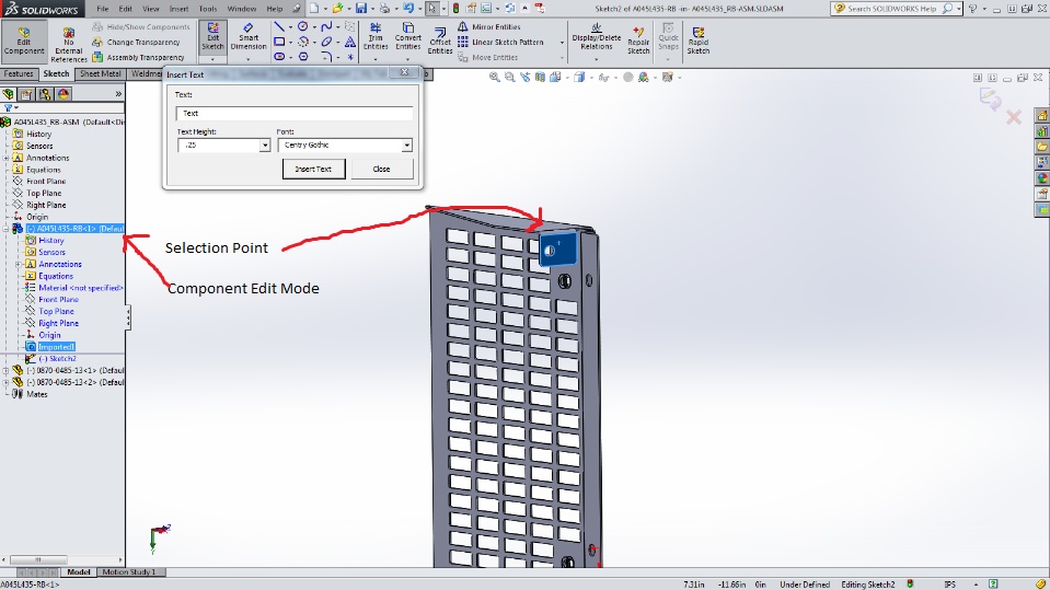

I am having an issue with a macro I have created that is supposed to add sketch text to a selection point within a sketch. The macro works great when I am working within a part document or using it within an assembly sketch. However, when I try using it within edit component mode, the location where the text is inserted isnt correct (see pics below). I am assuming it has something to do with which coordinate system the macro is using (ie it may be using the assembly coordinate system instead of the component part system).
If anyone know how to fix this I would be very grateful.
