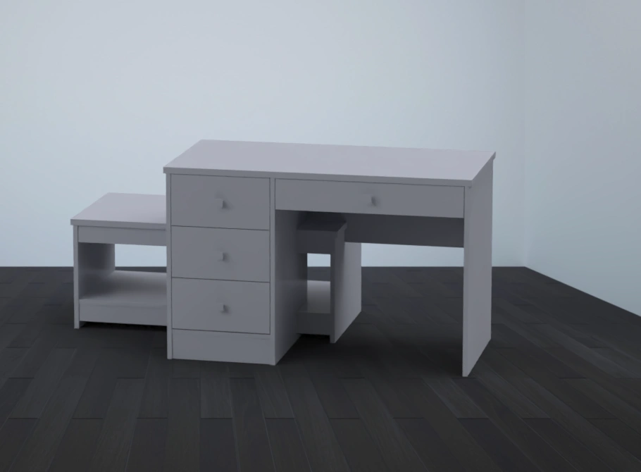

  1. I open a new project in visualise 2024 standard.
  2. import a new backplate (a room scene)
  3. I open project, model, import model and select an assembly (this pops onto the screen)
  4. I repeat point 2 to import another model.
  5. the 2nd model merges with the first imported model and I cant position then in room scene separately.
I'm trying to create a room scene where I position multiple items of furniture and hope there is an way around this merging issue.

WR 2025-03-18 Best Answer
on the right hand side of the view port you will see your tabs at the top. The first one is the "Models tab". Select it and go to the model you wish to move. Right click on that model and go down to Manipulate and then move, that model will be selected in the view port and an X,Y, Z manipulator will appear and you can now drag to your desired position.
RB
RB 2025-03-18
@Will Rodgers is correct.  New and/or imported models are placed in the center of the scene (relative to the origin in the model).  You must move them.  Here is a very quick video showing the use of the manipulator to move models in the viewport.
