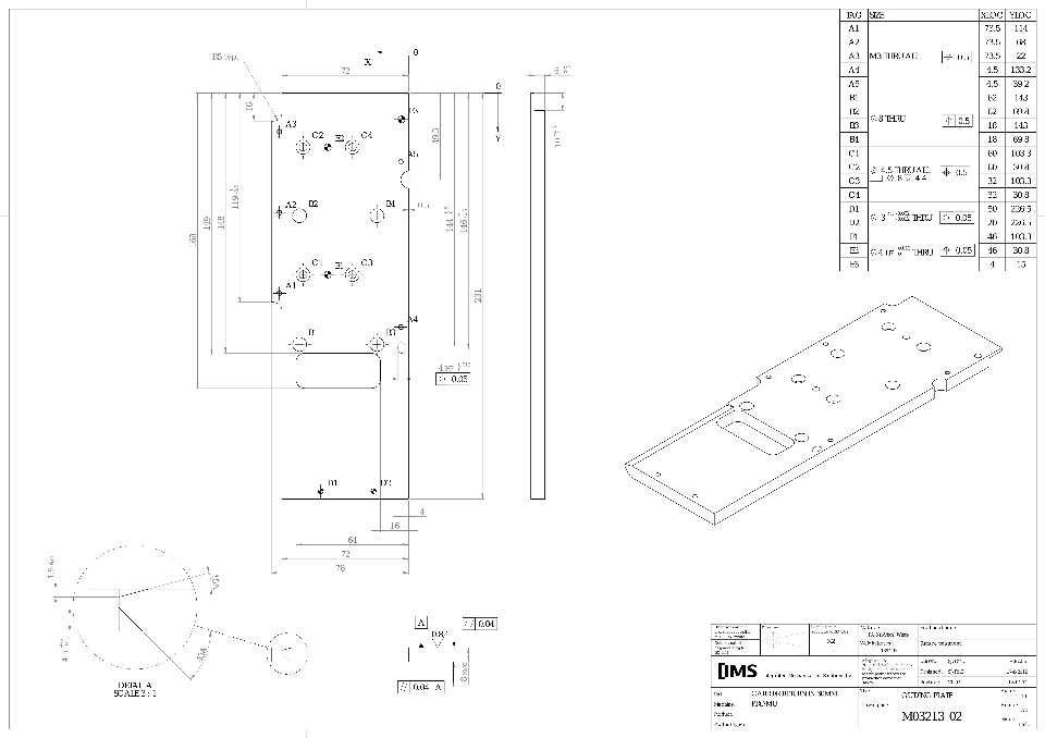

Please refer to the drawing attached.
Is there a way to link add the geometric tolerance precision of a hole to the hole table.
In the attached drawing, the geometric tolerances are just placed over the hole table.
Adding or removing holes, or moving the hole table around messes with the lay-out.
Thanks for any input.

I found a way to do it:
1. Click on note and then drawing area
2. Got to text format on note and click insert geometric tolerance.
3. Insert the geometrical tolerance.
4. Right click on geometrical tolerance and go down to edit text in window.
5. Copy paste the the command into the hole table.
