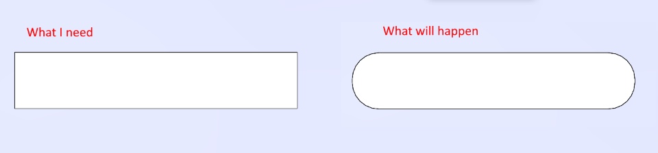

I am modeling 4mm thick sheet parts that will be machined with a CNC, and then assembled with tab-and-slot joints, like here:
The CNC bit that will be used to machine these parts has a diameter of 3.78mm, and these slots are 4mm wide, making it possible to machine them, except the inner 90° corners. My CNC machinist advised that if I provide a DXF that has simple rectangular cut-outs on my parts, the CNC machine will leave these inner corners rounded, making it impossible to assemble the parts later on:
The best solution for this would be to create reliefs in the corners - rounds of 3.78mm (or slightly more), to ensure that the tab will be able slide in without interference, resulting in a bone shaped slot:
(The construction lines represent the shape of the tab that will be inserted into this slot)
The extra gap left around these corners is of no concern. It will be filled during construction with other materials.
Now, my question is, what is the quickest and most convenient way to apply this corner treatment to all the slots in every part? Please note that these slots aren't always the same shape. They might be 4mm wide, but they might be wider (because parts will meet at angles other than 90°). Slot length varies as well. Features used to produce them vary too - some are simple cut-extrudes (in which case I could use the bone-shape slot in the first place), but most of them are produced with other features, and therefore require post-treatment. To produce the example above, I created a sketch block with a circle and some construction lines to help align the cutting circle to each corner with only two coincident relations:
Then copied this sketch block to every corner, and applied cut-extrude or surface trim, depending on the type of the part. The problem is - each slot has 4 corners, and there are nearly a thousand of these slots in my parts. Very few of these slots are alike in their shape and size, so I can't make any kind of block that would treat all 4 corners at the same time.
So, is there a better approach to solving this problem? What is the quickest and most convenient way to apply this kind of corner treatment to already existing slots? Since all my parts are flat, it can be either solid or surface based solution.

You could also just radius the corner of the slots with a smaller tool and then put chamfers on the end of the tabs. Works with metal and wood :-)
3.78mm seems like an odd size for a tool and my guess is that, unless it's a special it's probably a 9/64. Go down to a 3/32 or smaller and put a corresponding chamfer on the tab.
You could also put a generic corner relief drawing on and not model it at all. That allows the machinist to you use whatever tools, methods, etc that is easiest for them to get the tab to fit.

If you would be talking metal, then I would do it like I've done many times in the past, dog-bone shaped slot.  Since you're dealing with wood, what I would do is bevel the edges of the tab till they fit, basically takes seconds and once you get the process down it won't take long, plus you wouldn't have to use as much filler..

In that case you are stuck doing the T-Bone option, 3rd option Neville showed above. That's the best way that the machinist will be able to hold the overall length of the slot. That shape is pretty common for keys that need to be held in both directions.
Sadly as far as I know there is no "Automated" way to do this in SW. I have to draw that shape every time I use it.

If you're going to use filler why not just make it a slot and make it longer by the radius of the likely tool used?
The dogbone shape is just extra work. If you need the top tang supported then you would go with the T-Bone Shape Neville showed above.
