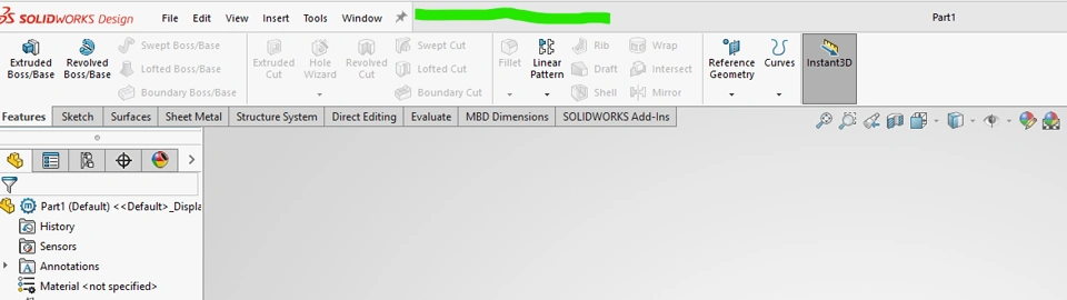

How do I get the red circled buttons on the top of the screen (green marked space)?

Hi Jorn, try right clicking on your Command Manager and choose Customize...
then, go to the Toolbars tab and choose Show in the Menu Bar under Quick Access Tools.

That space is not available to users. It is a system area. It would be nice if that is available.

@AO is correct, but I would like to point out that you need to have a file open. If you just have SW open, but not a file, then "Customize" isn't available.

In the Customize Dialog on the Toolbars tab. under Quick access tools, make sure that Show The Menu Bar is enabled.
