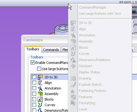

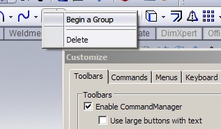

Right click on any toolbar and select customize or Tools > Customize, then right click on the location where you want to add the break. Select "Begin a group" to add the gap/break. If you looking to do this with API, I have no answer right now.
Deepak,
I am not getting what you have shown in your pic.
Maybe there is a setting somewhere that I am missing.

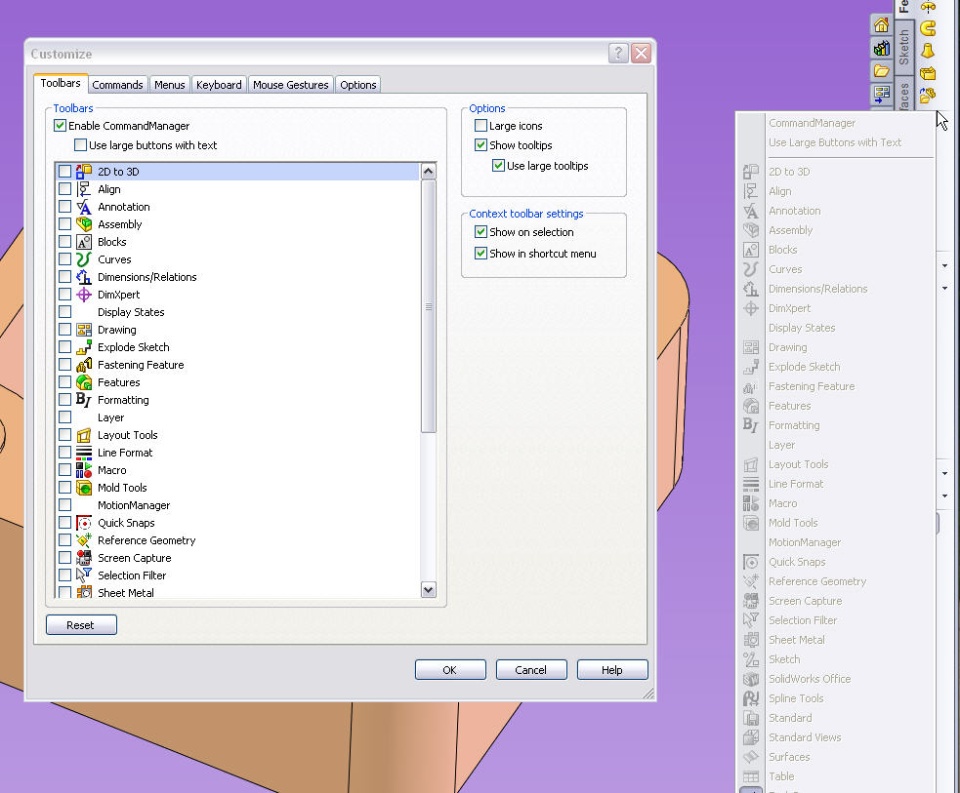

Here is a pic of what I am getting.
Scott, if you closely, I have right clicked on a toolbar whereas in your pic it just a plane bar. Try right clicking on a toolbar while in customize mode.
Deepak,
No matter where I pick all be it a plane tool bar or a regular tool bar I am still not getting
what you are getting.
FYI, I am using 2010 SP 3.1
Try clicking on an icon in the toolbar, in your pic, you are clicking on one of the "break bars". It looks like this only works in the command manager tool bar though. Standard toolbars don't seem to have this ability for some reason. (Note: I am using 2010 SP 4.0)
Yes Patrick, it seems to work on CM only
Scott,
It appears the answer is no, you cannot add breaks on toolbars, but you can on Command Manager.
Not much help for your problem, but an answer, no?
Alan,
Yes it is an answer. I finally got what Deepak was trying to show me all along. But like you said
only in the CM toolbar. Was looking do do it in a regular tool bar and for now that is not possible.
