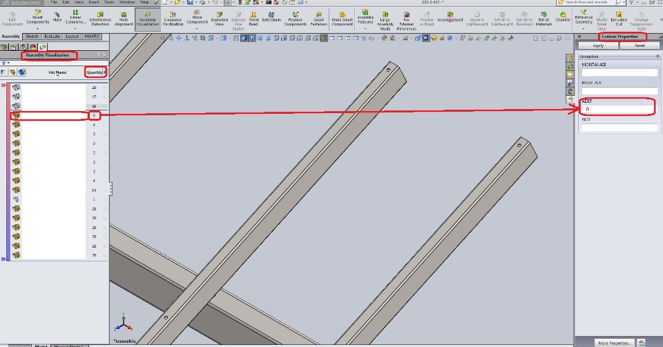

Do you want to take the quantity of a component in a given assembly and push it in a part custom property value?

Deepak, this workflow no longer works in 2015 and later, correct?
Putting code in equations is disabled from SW2012. Form SW2012 onwards SW removed the ability to compile the code in equations (but it allowed to work existing). In SW2015 you cannot add the code into equation ( it will flag error and cannot save) also the existing code will not work.
<p>Alin Vargatu wrote:</p><p></p><p><span style="color: #666666; font-size: 11pt;">Do you know if there is already a macro written for this?</span></p>
No I don't think there is any updated macro.

aseembly components QYT
custom components write
SW help mentions it as “Existing equations that do not follow this syntax are marked as errors because they create inconsistent results. You need to edit these equations to correct the syntax.”: http://help.solidworks.com/2015/English/SolidWorks/sldworks/c_wn_equations_in_assemblies.htm
Apparently SW made these changes for the user's security purposes.
yes
You will find a good macro here:
https://forum.solidworks.com/message/574580#comment-574580
